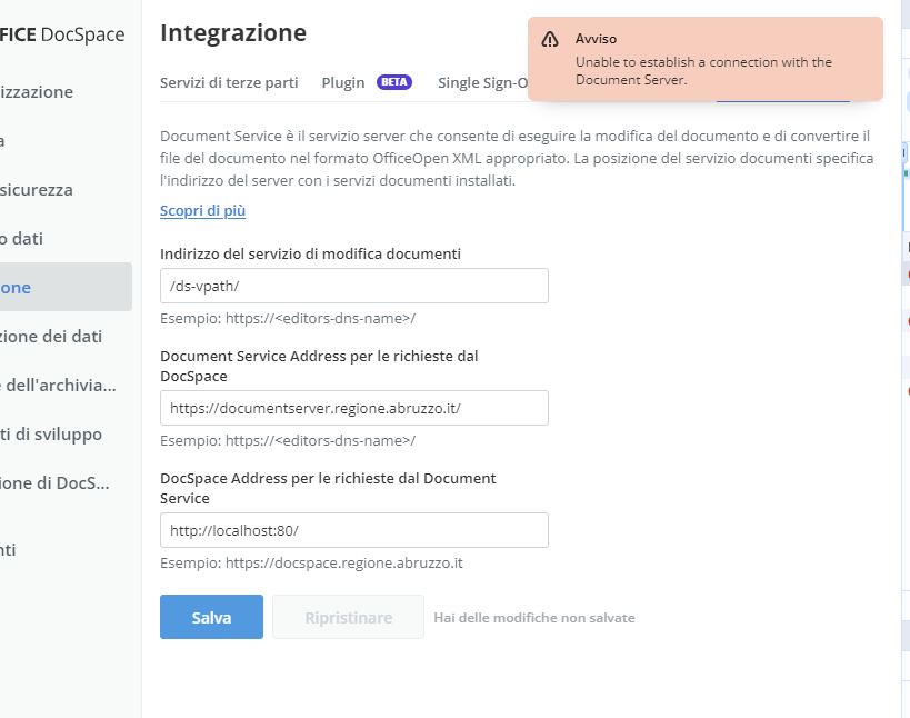

Good morning,
we installed onlyoffice docspace enterprise version via deb packages.
We have communication configuration problems between docspace and onlyoffice document.
Docspace and document will need to be configured behind an nginx reverse proxy. Both docspace and document are installed onpremise (package installation using docspace-install.sh) on the same server. We defined the reverse configuration for docspace as follows,
HTTPS server
server {
listen 443 ssl;
server_name docspace.regione.abruzzo.it;

Both docspace and document are configured in http and the https part is on the nginx reverse proxy (ngix reverse is the SSL termination). We have several problems. The first is that we are unable to configure the document service on docspace and we receive the following error.

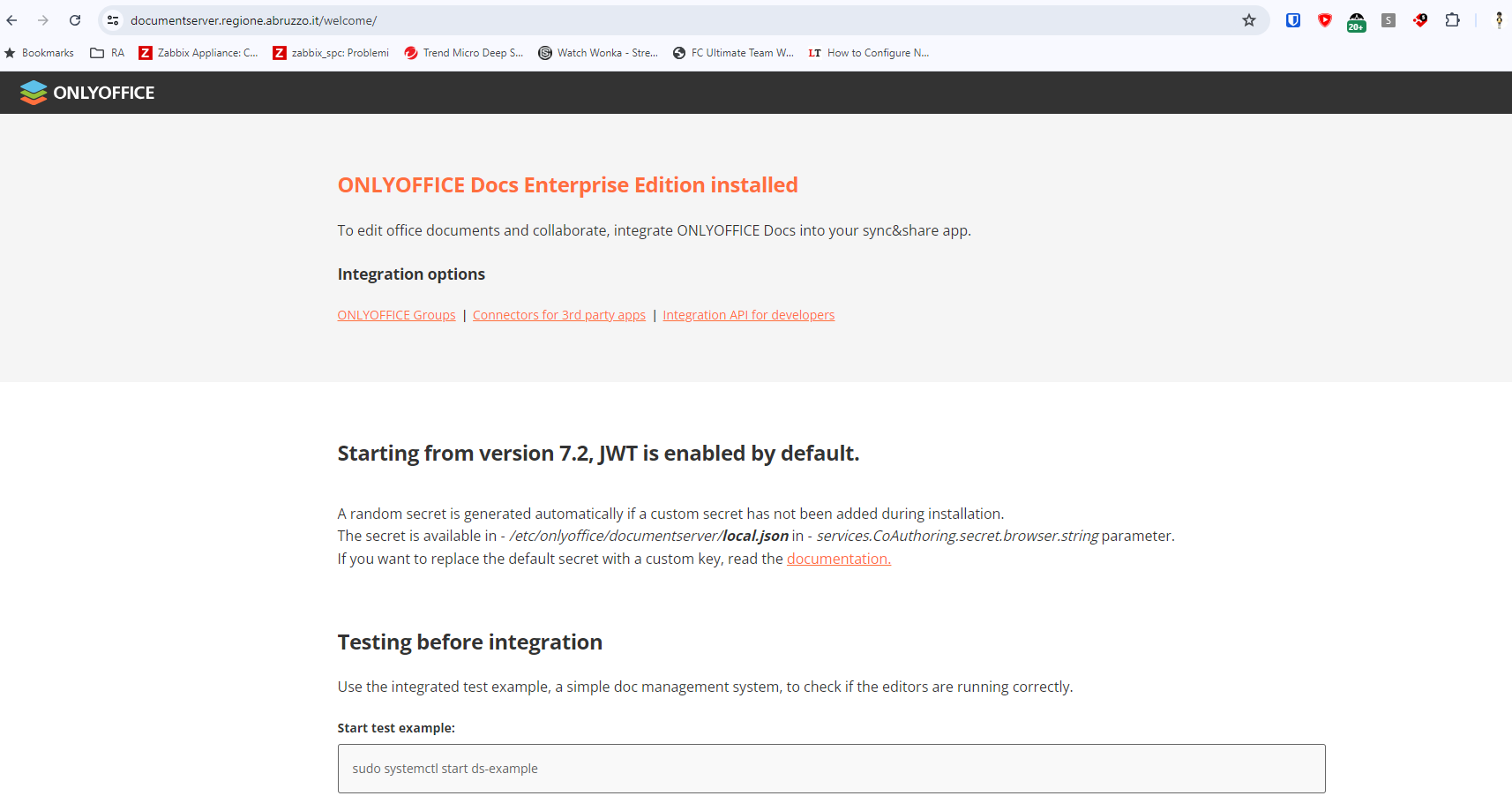

but documentserver working with fqdn
Have we made any mistakes on the reverse side configuration? is there any further configuration to do on the docspace side?
