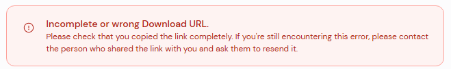

It seems the link to the txt file is incomplete.
Sorry about that - have uploaded again:
I’m afraid the link is still not working. Could you try some other file hosting?

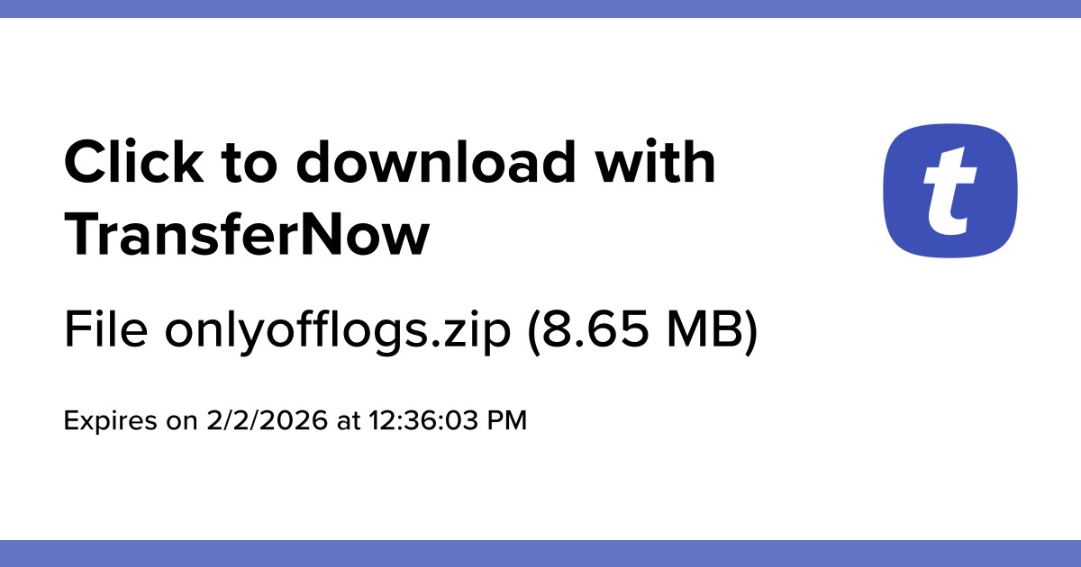

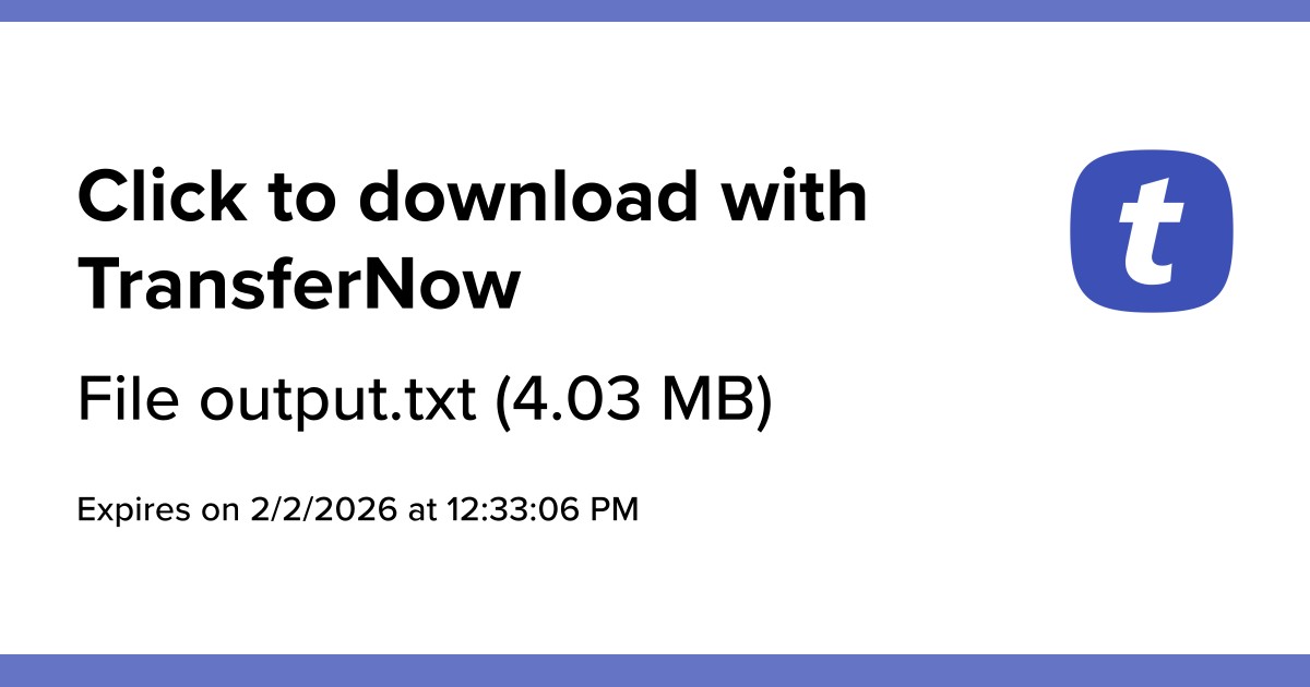

Hi Carl
Sorry for delay please see link for the docker log output txt here:
Only Office Log archive here:
