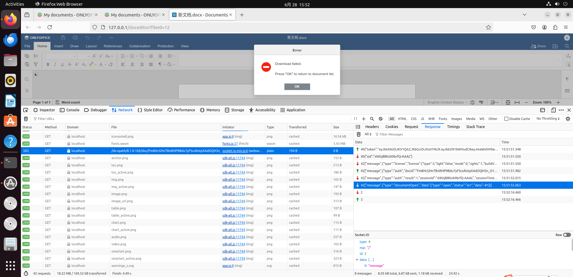

Download failed,(error downloadFile:url=http://localhost:80/filehandler.ashx,statusCode:403)
I keep getting the error download failed when opening a newly created document.
I looked at the log file /var/log/onlyoffice/documentserver/converter/, and the problem that kept coming up was:
nodeJS - error downloadFile:url=http://localhost:80/filehandler.ashx? action=stream&fileid=13&stream_auth=456975222837.CGY1KKVM3MBYMR8CTR0O8BLKOMVR4XL5CEVQAO6LAN0; attempt=3; code:null; connect:null Error: Error response: statusCode:403; Headers: {" server “:” openresty / 1.25.3.1 ", “date” : “Tue, 25 Jun 2024 01:33:46 GMT”,“transfer-encoding”:“chunked”,“connection”:“keep-alive”}.
/var/log/onlyoffice/docspace/files.log.I found an error in this file information, 2024-06-25 10:05:04, 231 ERROR [81] ASC. Web. Files. FileHandlerService - Download stream header http://localhost/filehandler.ashx? Action = stream&fileid = 13 & stream_auth = 456977100824.39 U4PGR8UOLH7ZTFAQ2REV46A3J8WJ7ECRZHXCD4W System. Exception: Invalid signature header AuthorizationJwt with value .Trace headers: Connection=close

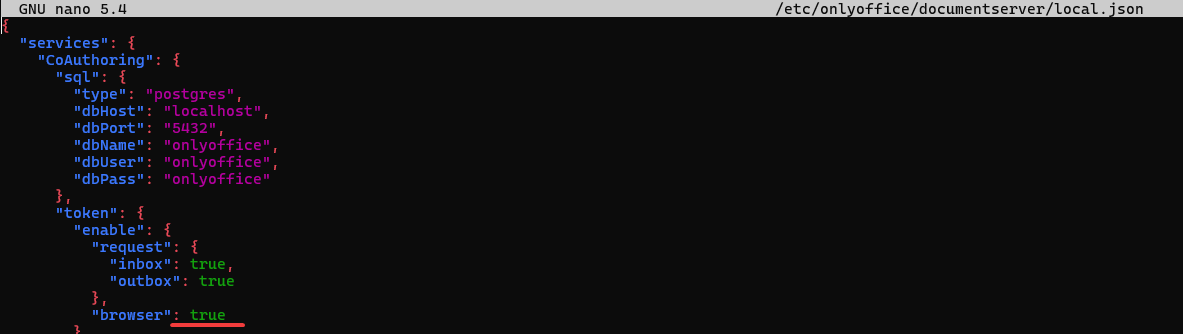

2.I also changed the attribute of the local.json services.token.browser to false.

  1. Update the value in the local.json file to:
"browser": true
1.1 Execute the following command to apply the settings:
systemctl restart ds-*
  1. Try opening the document in your browser and include a screenshot from Chrome’s DevTools Console and Network tab.

@Nikolas thank you! I set the attribute “browser”: true, and the system can be accessed normally.

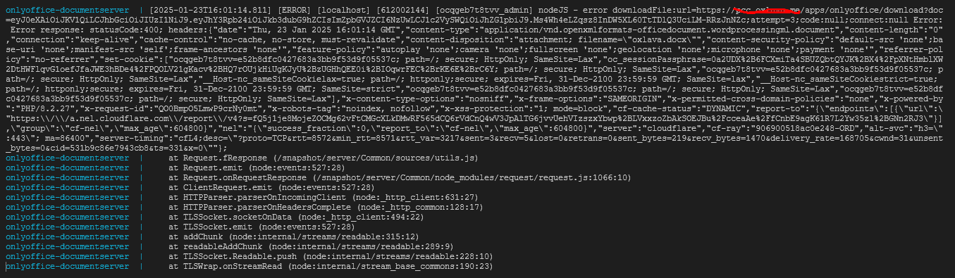

I encountered a similar issue while using Docker to install the OnlyOffice Document Server. The integration with Nextcloud was successful, but attempting to open documents results in a download failed error. Nextcloud and Onlyoffice is behind Traefik.
Below is the error log from the OnlyOffice Document Server:
[2025-01-23T16:01:14.811] [ERROR] [localhost] [612002144] [ocqgeb7t8tvv_admin] nodeJS - error downloadFile:
url=https://xxx.x.x.x.x…me/apps/onlyoffice/download?doc=eyJ0eXAiOiJKV1QiLCJhbGciOiJIUzI1NiJ9.eyJhY3Rpb24iOiJkb3dubG9hZCIsImZpbGVJZCI6NzUwLCJ1c2VySWQiOiJhZG1pbiJ9.Ms4Wh4eLZqsz8InDW5XL60TtTDlQ3UciLM-RRzJnNZc;
Error: Error response: statusCode:400;
headers: {
“date”: “Thu, 23 Jan 2025 16:01:14 GMT”,
“content-type”: “application/vnd.openxmlformats-officedocument.wordprocessingml.document”,
“content-length”: “0”,
“connection”: “keep-alive”,
“cache-control”: “no-cache, no-store, must-revalidate”,
“content-disposition”: “attachment; filename="oxlava.docx"”,
“content-security-policy”: “default-src ‘none’;base-uri ‘none’;manifest-src ‘self’;frame-ancestors ‘none’”,
“feature-policy”: “autoplay ‘none’;camera ‘none’;fullscreen ‘none’;geolocation ‘none’;microphone ‘none’;payment ‘none’”,
“referrer-policy”: “no-referrer”,
“set-cookie”: [
“ocqgeb7t8tvv=e52b8dfc0427683a3bb9f53d9f05537c; path=/; secure; HttpOnly; SameSite=Lax”,
“oc_sessionPassphrase=0a2UDX%2B6FCXmiTa4SBUZQbtQYJK%2BX4%2FpXNtHmblXW2DtHWFlqvG1oefJfaJWE3hBDe4%2FPQOLV21gKacv%2BHQ7rOUjkHiUgKJyU%2BzUGHhQEE0i%2BIOqwrFEC%2BrKE6E%2BrC6Y; path=/; secure; HttpOnly; SameSite=Lax”,
“__Host-nc_sameSiteCookielax=true; path=/; httponly; secure; expires=Fri, 31-Dec-2100 23:59:59 GMT; SameSite=lax”,
“__Host-nc_sameSiteCookiestrict=true; path=/; httponly; secure; expires=Fri, 31-Dec-2100 23:59:59 GMT; SameSite=strict”
“x-content-type-options”: “nosniff”,
“x-frame-options”: “SAMEORIGIN”,
“x-permitted-cross-domain-policies”: “none”,
“x-powered-by”: “PHP/8.2.27”,
“x-request-id”: “QO0BmpO5LmwP9crNy0mt”,
“x-robots-tag”: “noindex, nofollow”,
“x-xss-protection”: “1; mode=block”,
“cf-cache-status”: “DYNAMIC”,
“report-to”: "{"endpoints":[{"url":"https://a.nel.cloudflare.com/report/v4\“}],\“group\”:\“cf-nel\”,\“max_age\”:604800}”,
“nel”: “{"success_fraction":0,"report_to":"cf-nel","max_age":604800}”,
“server”: “cloudflare”,
“cf-ray”: “906900518ac0e248-ORD”

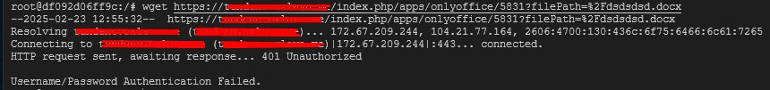

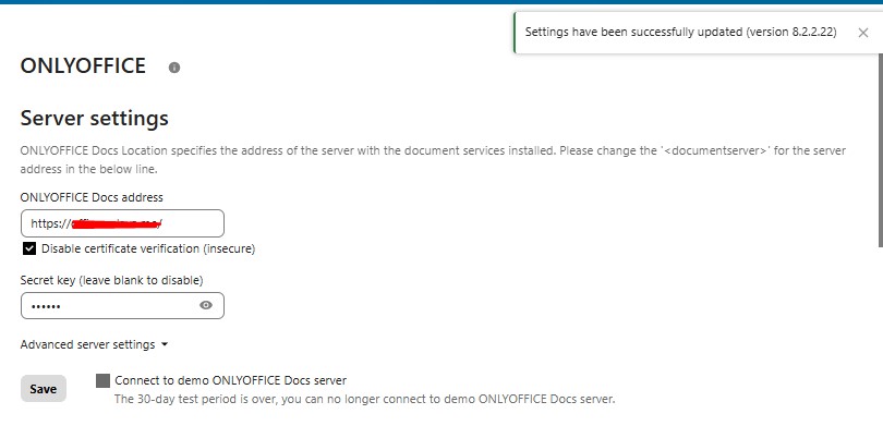

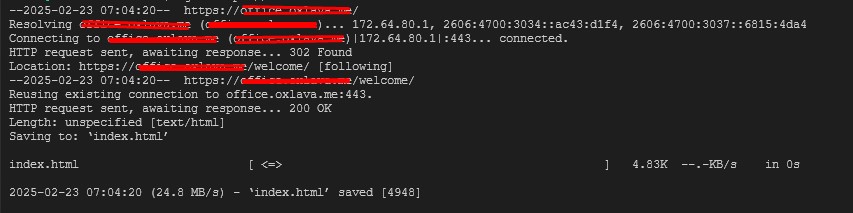

SCREENSHOTS OF ERRORS
  1. From the Document-server, I got this feedback
  2. From the DMS server, I got this feedback
  3. Here is the integration from Nextcloud
