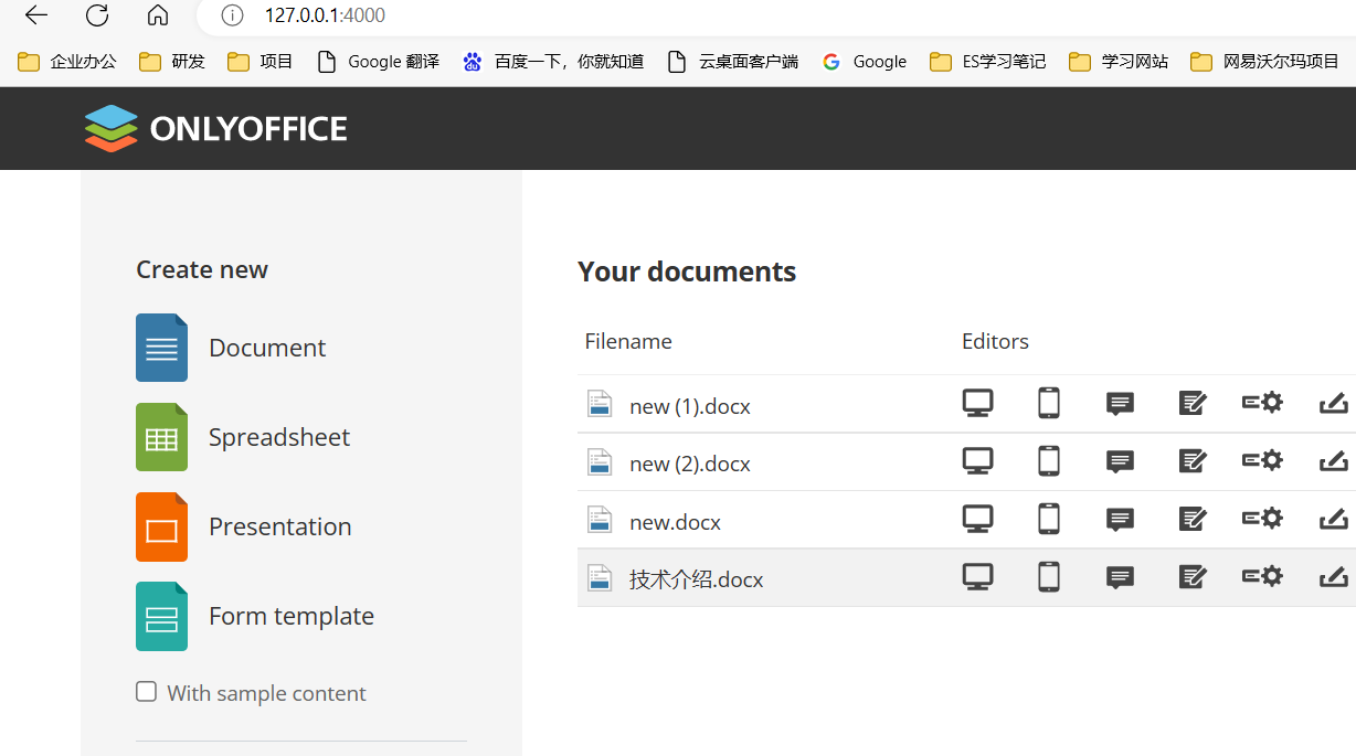

- I install onlyoffice
- I download java spring example.
- I can upload file and download file but when I edit file fail.

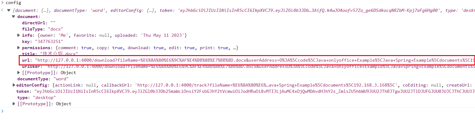

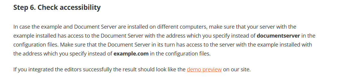

- I find the DocsAPI config
this url is right. I can use it down load file in browser(Although a little slow). so I don’t konw how to continue.
Actually, I do nothing except configure “files.docservice.url.site”.

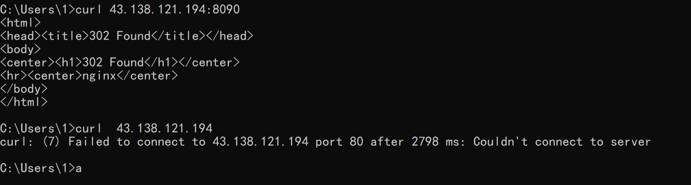

Please check if these servers can be accessed by each other.
From Docker container with Document Server perform wget <java_spring_address> and from Windows via Command Line use curl <document_server_address>. After that please share results.
Also, please provide \src\main\resources\application.properties config of the Java Spring Example from your Windows machine for analysis.
Using curl on windows, I get the following result:
I used the wget command on a linux server with the following results:
the config of the Java Spring Example as follow:

So as I can see there is an issue with connectivity between servers. I think you need to resolve it in the first place before we can move on.

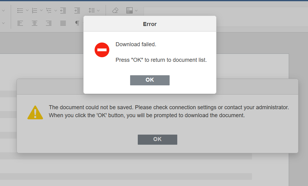

hello@ Constantine,I’m sorry to bother you again.When I put the java spring example and onlyoffice server on the linux server, the download failed error still occurs when I run the java spring example. The log information in out.log is as follows:
[2023-05-31T14:25:00.502] [ERROR] [localhost] [-22343002] [1] nodeJS - postData error: url = //track?fileName=new.docx&userAddress=%2Froot%2Fdocuments%2F127.0.0.1%2F;data = {"key":"-22343002","status":1,"users":["1"],"actions":[{"type":1,"userid":"1"}],"token":"eyJhbGciOiJIUzI1NiIsInR5cCI6IkpXVCJ9.eyJrZXkiOiItMjIzNDMwMDIiLCJzdGF0dXMiOjEsInVzZXJzIjpbIjEiXSwiYWN0aW9ucyI6W3sidHlwZSI6MSwidXNlcmlkIjoiMSJ9XSwiaWF0IjoxNjg1NTQzMTAwLCJleHAiOjE2ODU1NDM0MDB9.hP5VK2KUNLoCnO4emoz-4CbacfGxsGxY3DupnSGmvfk"} Error: Invalid URI "//track?fileName=new.docx&userAddress=%2Froot%2Fdocuments%2F127.0.0.1%2F"
