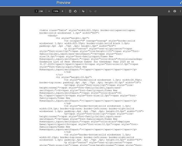

Docx to pdf issue and html to pdf conversion issue
We are using community version of only office API.When uploading a .docx file and converting to PDF via the OnlyOffice conversion tool, the output PDF sometimes contains corrupted or unreadable content. This happens even with simple, valid .docx files.

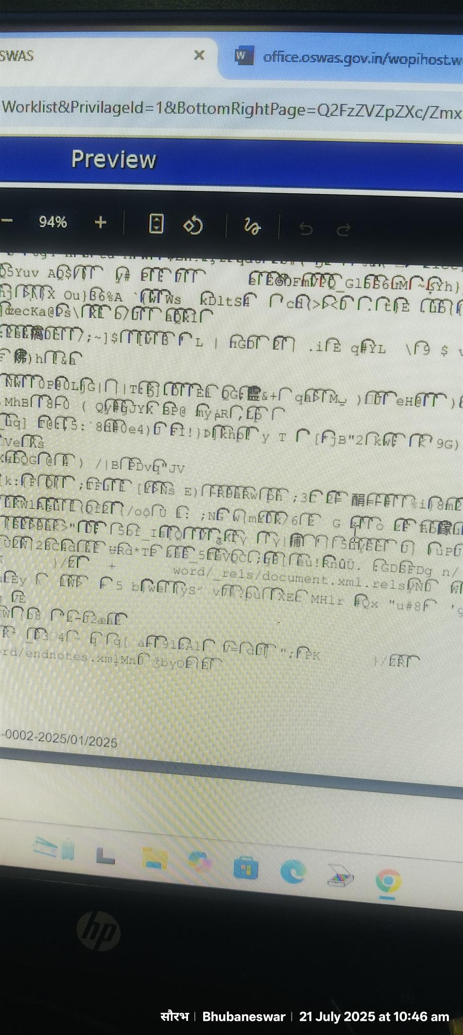

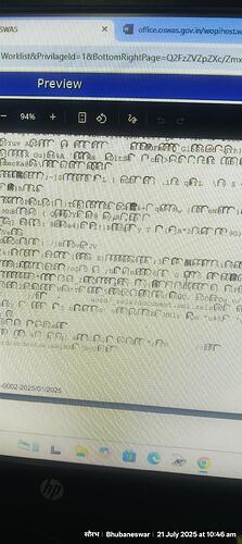

Thanks for looking into this. The file does not appear to be corrupted, since we are able to successfully convert the same document to PDF using the Office API in our test and pre-production environments. Also the same file is converted to pdf using libre office. The issue only occurs in production while using only office API, where the converted PDF outputs unreadable / gibberish content.

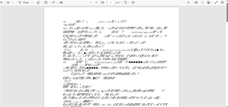

I’m experiencing the same issue on OnlyOffice Document Server 9.2.1.1.
When converting DOCX to PDF via the ConvertService API, the resulting PDF sometimes contains the raw binary content of the DOCX file rendered as plain text instead of the actual converted document. The PDF metadata confirms it was generated by onlyoffice/9.2.1.1.
The issue is intermittent — I can repeat the exact same conversion request with the same download URL and it works correctly most of the time. The DOCX file is valid and accessible, and the conversion succeeds on retry. This suggests it may be a concurrency or resource-related issue rather than a problem with the document itself.

I found the root cause of this issue in my environment.
It’s a race condition between the ConvertService download and a force_save callback (status 6) overwriting the same file on disk.
Here’s what happens:
  1. A user submits a form that triggers a DOCX to PDF conversion via ConvertService.ashx
  2. The ConvertService receives the file URL and starts downloading the DOCX
  3. Meanwhile, a force_save callback arrives from the Document Server and overwrites the same file on disk with an updated version
  4. The ConvertService ends up downloading a partially written/truncated file
  5. Since the downloaded content is not a valid DOCX, the Document Server falls back to treating it as a plain text file
  6. It then renders the raw binary content as text inside a PDF
I confirmed this by comparing the binary content rendered in the PDF with the original DOCX binary — the PDF is missing the final portion of the file, which is consistent with reading a file while it was being overwritten.
I understand that the download itself succeeded (HTTP 200 with content), so returning a download error like -3 wouldn’t apply here. However, the ConvertService knows the expected input format because we pass the filetype: "docx" parameter in the request payload. It could validate that the downloaded content is actually a valid DOCX file (e.g., checking for the ZIP magic bytes “PK” and a valid ZIP structure) before attempting the conversion.
When the downloaded content doesn’t match the declared filetype, the ConvertService should return an error instead of silently falling back to plain text rendering. The current behavior generates a PDF that looks like a successful conversion, making the failure very hard to detect programmatically.
On my side, I’m fixing the race condition by copying the file to a temporary location before sending the URL to the ConvertService. But I believe the input validation improvement would help other users who might encounter similar issues.
