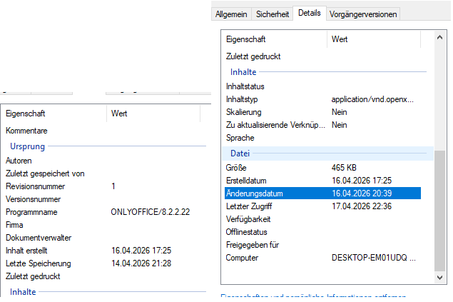

The strange thing is, that the file with the missing data has the correct time stamp if the moment, when I stopped working on it in the evening, but the size has not changed compared to the file two days ago, which I used as basis for my work. see below.
So somehow the file saved the timestamp of changes, but not the content change itself. The whole tab I added is missing. The original 4 tabs are still there. Sorry, dont know, if tab is the right word, hope you understand what I mean.^^
Any further ideas?
I hoped, there might be temporary versions saved somewhere, but I dont know where to search for something like this.
grafik
Here also the other details from the file: On the right you see the date of last change,which did not save the content, on the left the dates of the original, which are the time stamps of the basis file created 2 days ago and the time, when I copied it to start working.
