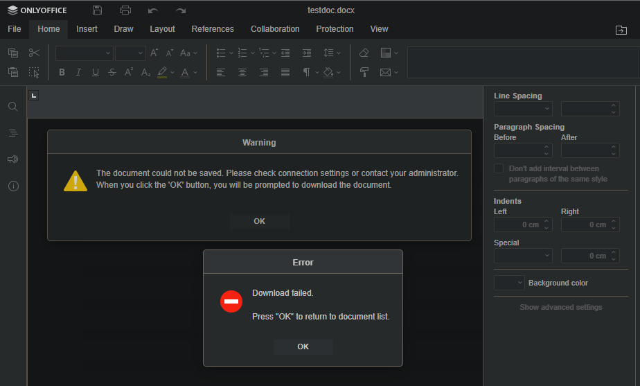

Getting this error:

The nginx.error.log is empty. The only place I could find some kind of an error from the logs was in converter/out.log:
[2023-08-29T17:34:16.657] [ERROR] [localhost] [1171698409] [uid-1] nodeJS - error downloadFile:url=http://<PC_NAME>/webeditor-ajax.php?type=download&fileName=testdoc.docx&userAddress=fe80__3707_a2d1_258d_57df;attempt=3;code:undefined;connect:undefined Error: Error response: statusCode:404; headers:{"date":"Tue, 29 Aug 2023 17:34:16 GMT","server":"Apache/2.4.51 (Win64) OpenSSL/1.1.1l PHP/8.0.13","content-length":"294","keep-alive":"timeout=5, max=100","connection":"Keep-Alive","content-type":"text/html; charset=iso-8859-1"};

I can also see the file pop up in the docStorage directory when I upload one from the interface. Not sure what’s wrong, but I would greatly appreciate any advice on how to get this up and running! Thank you.
edit: forgot to mention. The http://<my_ip>:8090/example/ works perfectly, can upload docs, create new docs, and edit with no problems.
edit: new error started showing up in nginx.error.log
2023/08/29 19:22:41 [error] 7278#7278: *318 connect() failed (111: Unknown error) while connecting to upstream, client: 172.17.0.1, server: , request: "GET /7.4.1-36/doc/1171698409/c/?EIO=4&transport=websocket HTTP/1.1", upstream: "http://127.0.0.1:8000/doc/1171698409/c/?EIO=4&transport=websocket", host: "<my_ip>:8090"
