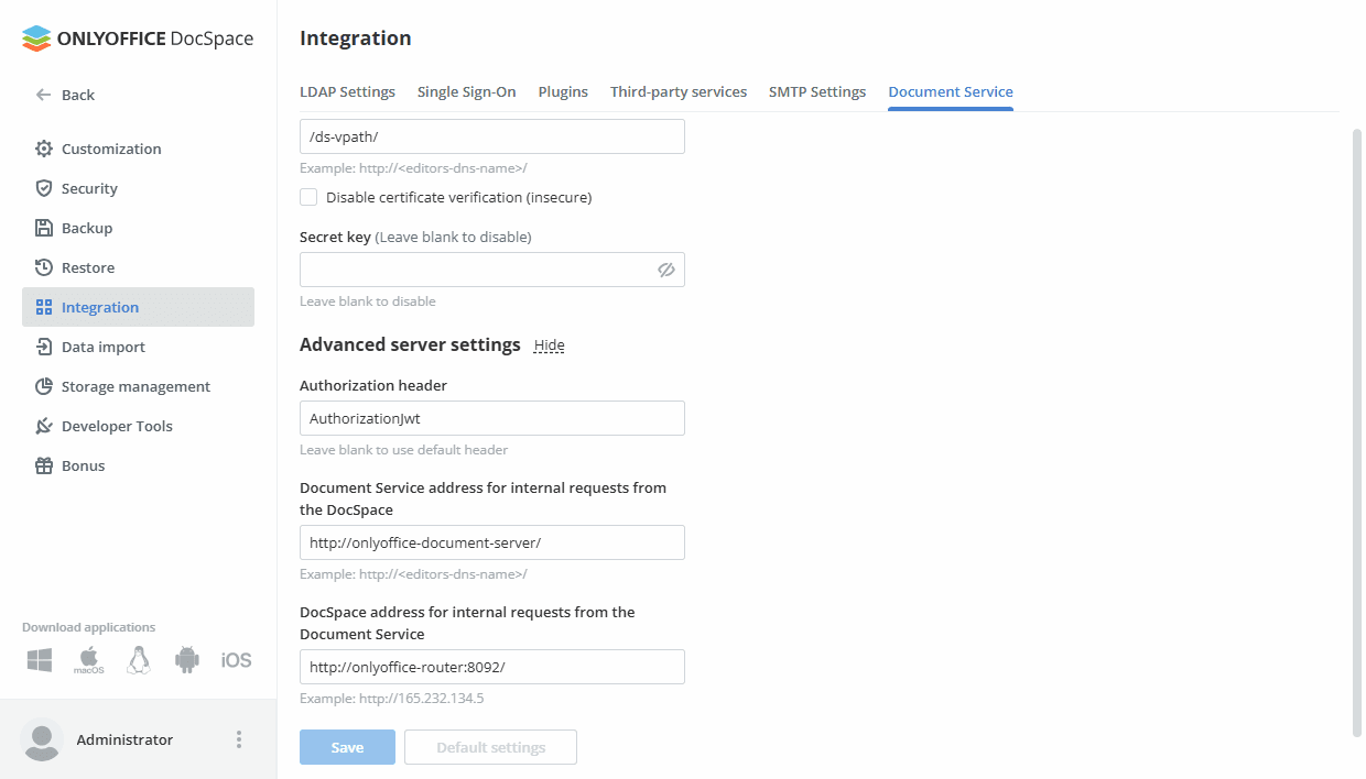

Now a new problem has arisen, and in the process of solving it, I discovered the root of the problem, which explains everything that happened before.
I restarted the virtual machine where OnlyOffice is installed today, and the same problem has reappeared: clicking on a file doesn’t open the editor in a new window; instead, it downloads the file.
After extensive observation and testing, I found that in versions 9.2 and later, the aforementioned issue occurs directly upon the first creation and startup of the container. Installing version 9.1 first, followed by upgrading to version 9.2 or higher, temporarily resolves the issue. However, if the configuration shown in the image below is not manually configured, all configurations will disappear after a container or machine restart, causing the problem. Manually re-entering the configuration shown in the image restores normal operation, allowing for restarts without recurring the issue.

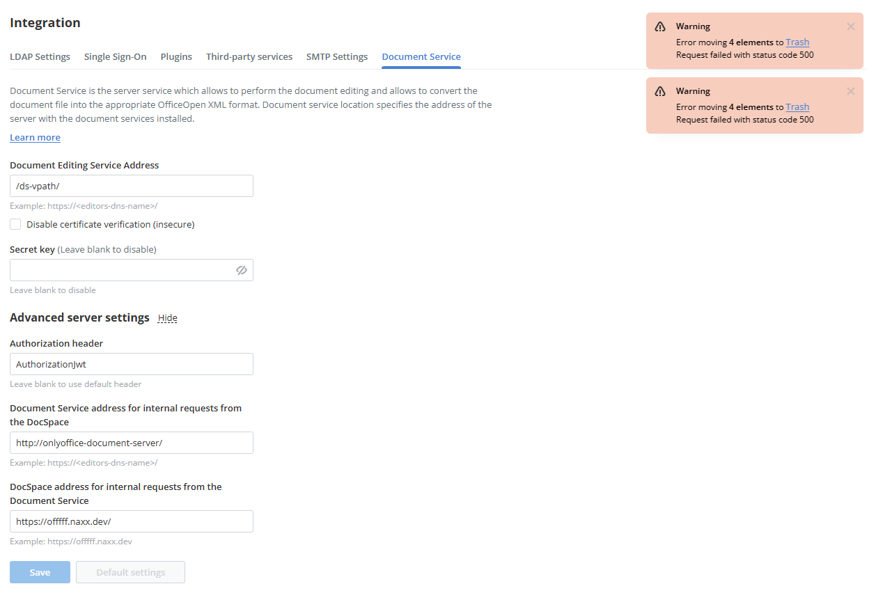

Hey Alexandre, thanks for the reply. Today I did a clean install of the latest docspace version 9.3.1.1 on Debian 13, using Docker. The previous problem no longer occurred; the editing page opens normally after restarting the virtual machine, but a new problem has appeared.
Whether it’s the sample files in the default personal space or files uploaded by myself in the public room, deleting them results in a 500 error. I’ve attached screenshots.
Note: The DocSpace address for internal requests from the Document Service option in the screenshot is the default setting. I also tried changing it to http://onlyoffice-router:8092, and it saved successfully, but the problem persists. Also, I can’t upload zip files, please tell me how to send /var/lib/docker/volumes/onlyoffice_log_data/_data.

Hello @azip52
Asc.Files.log file contains such entries:
RabbitMQ.Client.Exceptions.ConnectFailureException: Connection failed, host 172.18.0.27:5672
Please make sure that RabbitMq contrainer is running (run docker ps command). Also you can check container logs: docker logs onlyoffice-rabbitmq
If it’s necessary, try to restart that container. Please let us know the result.
