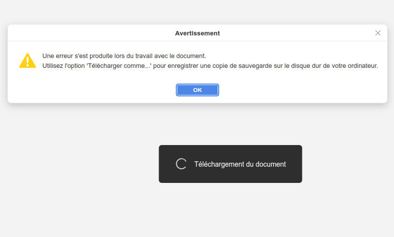

i’m trying to use GetFileToDownload method in my plugin
but i get this error when running the plugin; either on an existing document or a new unsaved document .
NOTE : Original format and the requested one are identical.

Hello @Antoine
We will check the situation, then I’ll provide a feedback.
do you have check this issue ? Is it possible to use GetFileToDownload in Plugin mode to retrieve converted file content and use it in a webApi ?
Thanks for advice and help
Antoine
Sorry for the delayed response. This method has a bug, which prevents it from working in Desktop Editors, as it is not suited for desktop environment.
Sorry for the inconvenience.
