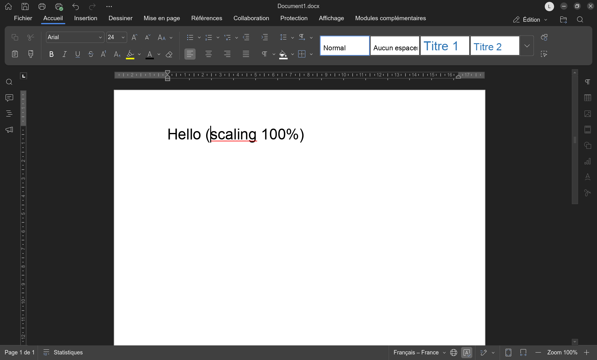

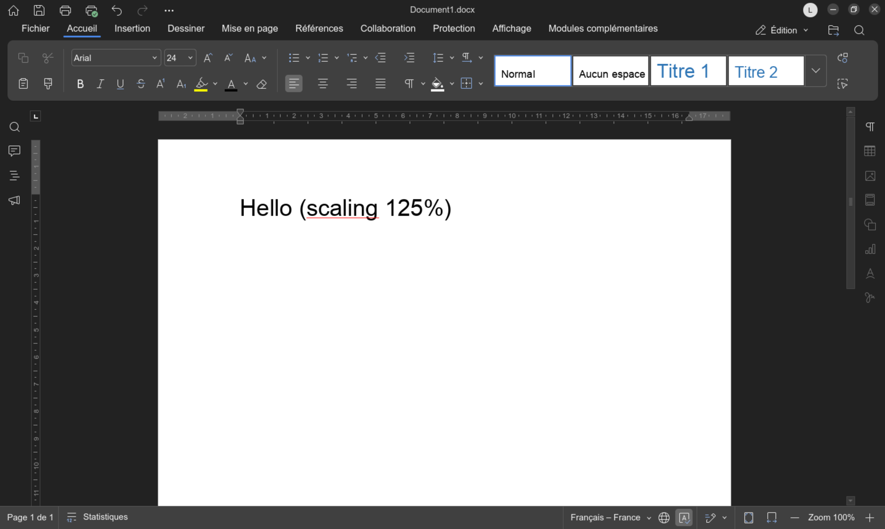

I’m experiencing a consistent issue with the Flatpak version of ONLYOFFICE Desktop Editors under GNOME on Wayland, especially when using fractional scaling (e.g. 125% or 150%). The interface appears noticeably blurry, and text rendering is degraded compared to other apps.
System details:
OS : ZorinOS (GNOME 43.9 on Wayland)
Kernel: 6.8.0-60-generic
Scaling : 125% (fractional)
UI appears blurred due to scaling; likely running through XWayland fallback
What I’ve tried:
  • Set Flatpak environment variables (GDK_SCALE, GDK_DPI_SCALE, ELECTRON_OZONE_PLATFORM_HINT, GTK_BACKEND, etc.)
  • Enabled Wayland socket in Flatseal
  • Forced --ozone-platform=wayland and --force-device-scale-factor=1.25
  • Tried GNOME’s xwayland-native-scaling experimental feature
None of these changes resolved the blurriness. From what I can tell, the application is still running via XWayland, and the rendering is being upscaled with interpolation, resulting in a fuzzy UI.

Hey @Mkt987 :wave:
Thank you for the detailed report!
Could you please provide a short screen recording or screenshots to visually demonstrate the blurriness issue you’re encountering?
This would help us better understand the severity and specifics of the problem, especially under 125% scaling.
We’ll try to reproduce it on our side as well — it’s possible that the issue is specifically related to certain fractional scaling values like 125%.
Thanks again!
In the meantime, I installed the .deb version and I have exactly the same problem.
Hello @Mkt987
Sorry for the late reply.
Recently we released v.9.0.3 of the Desktop app. Please confirm whether the issue with blurred UI still occurs on the latest version.
