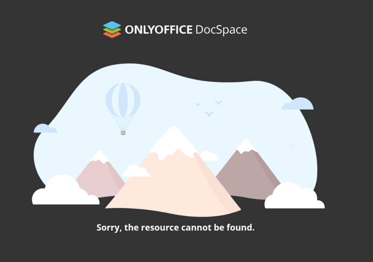

When I try to access the wizard at https://office.home.private/wizard, I get:
  • HTTP 500 error with a redirect loop between /wizard and /unavailable
  • The root path redirects to /welcome showing “Sorry, the resource cannot be found”
Looking at the login container logs, I see:
Error: Not Found
    at async h (/var/www/products/ASC.Login/login/.next/server/app/(root)/wizard/page.js:8:28877)
TypeError: fetch failed
  [cause]: Error: connect ECONNREFUSED 127.0.0.1:8095
It looks like the login container is trying to fetch data from 127.0.0.1:8095 during server-side rendering, which fails from inside the container.
