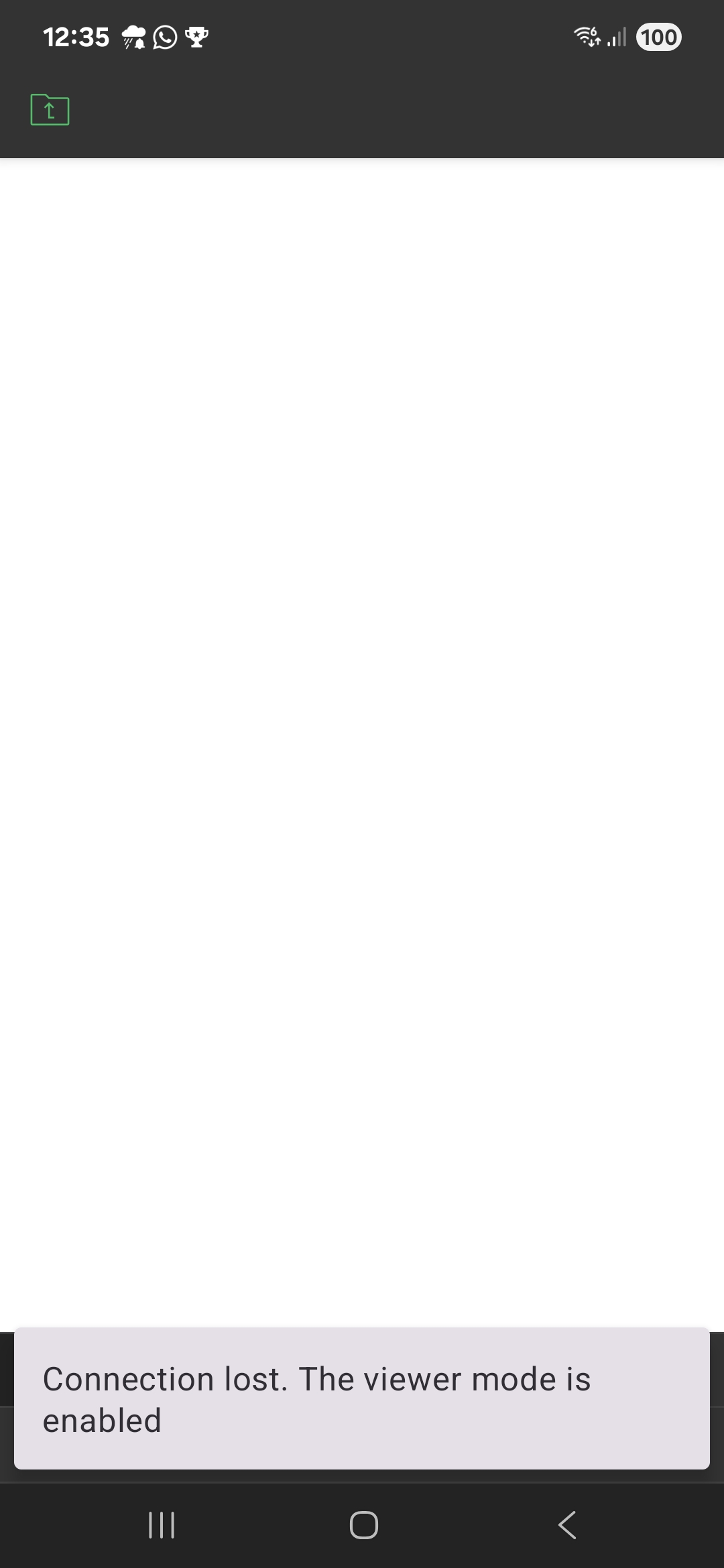

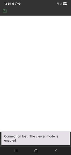

Connection Lost. Viewer Mode Enabled
Device: Samsung Galaxy A55
OS version: Android 15 / One Ui 7.0
App version: 9.0.4
Mode: Connect to Cloud
Additional information:
When I try to view a document in the DocSpace, I get the ‘Connection Lost. Viewer Mode Enabled’.
But I still can’t see the file. It happens on both of my Android devices, but is fine on my PC.
I’ve tried clearing cache, clearing data, uninstall, reinstall. Restarting in between.
Still get the same error.

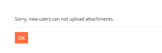

I got a screen recording but I’m not allowed to upload
Hello @mikael63
Your Community level has been increased, you can attach files to your posts. Please attach video file and the sample of file where the issue occurs.
Wouldn’t let me upload screen recording, but exactly the same as @mikael63
