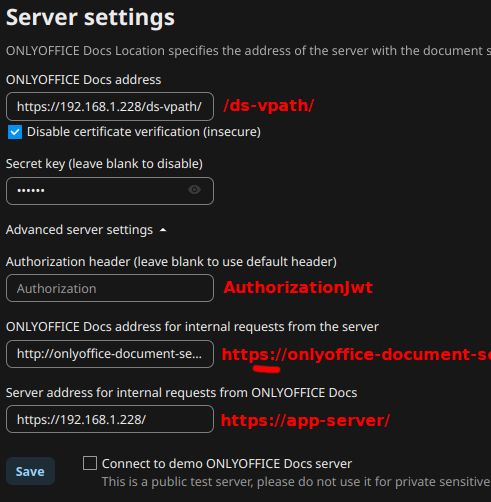

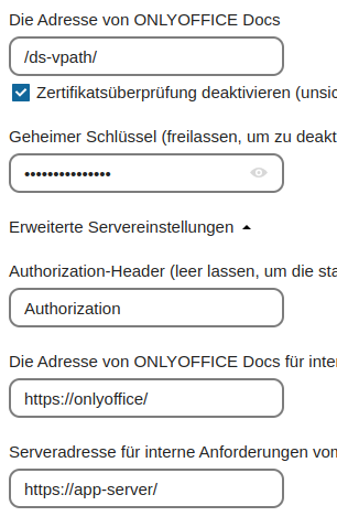

What are you connector app settings? You have “/ds-vpath/” configured in your reverse-proxy configuration. Do you use it as address to your OO service in the connector app?
This is how your connector app should look like, based on your configuration:
connector-app
But I would ask you to change “Authorization” to “AuthorizationJwt”.

Sorry, https://onlyoffice/ in connector app should be https://onlyoffice-document-server/ in your case.
Also make sure “onlyoffice-document-server” is included in your nextcloud config under “trusted_domains”.

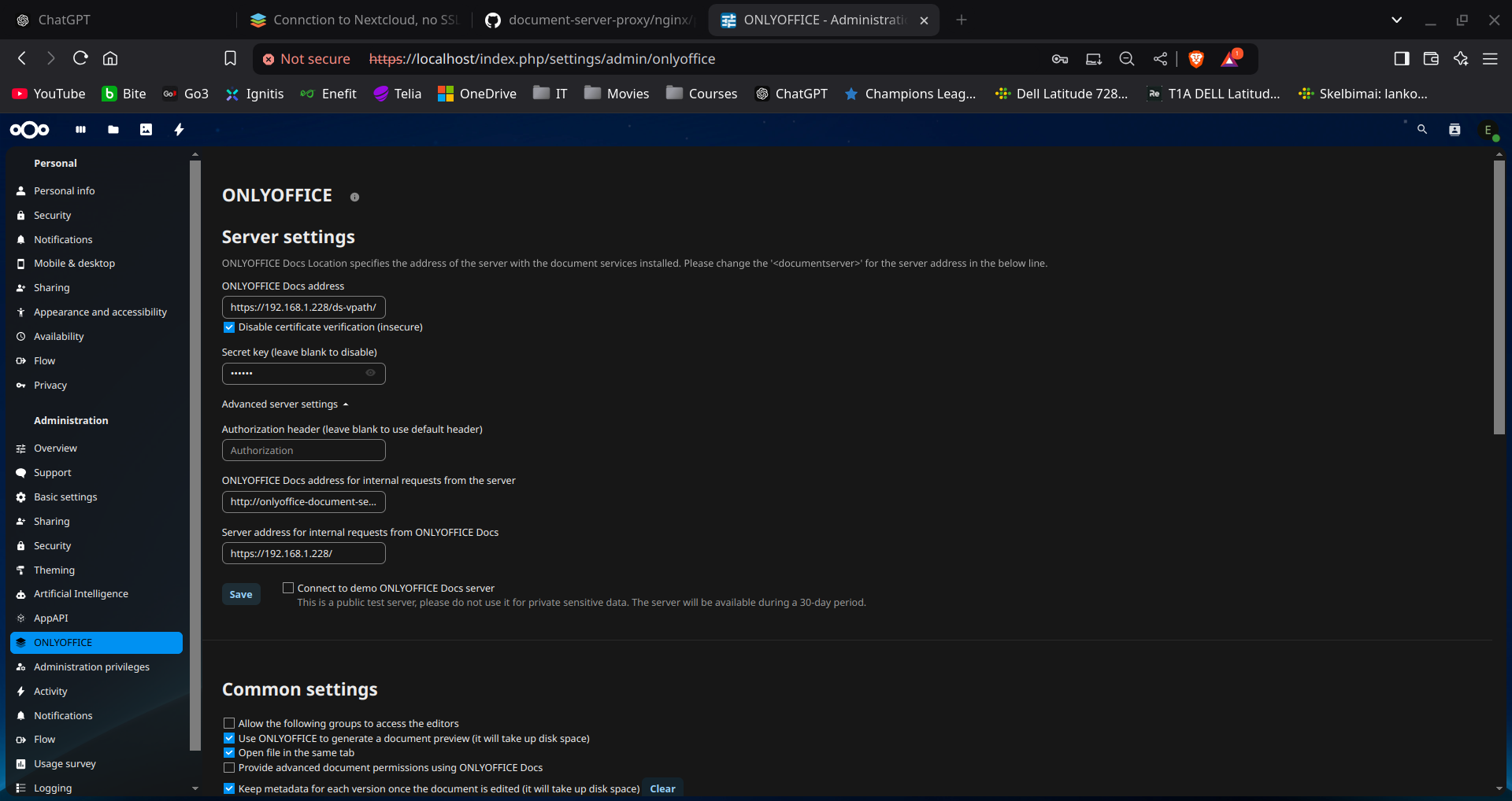

here is what is set.
it connect to onlyoffice, but then error “ONLYOFFICE cannot be reached. Please contact admin” comes when trying to edit documents.

Your connect app should look like this:

This is the closest I’ve got, because it at least connects to onlyoffice from nextcloud, but fails to download documents. When I try other options, like settings https:onlyoffice-document-server for ONLYOFFICE Docs address for internal requests from the server it doesn’t even connect to the server.

Hello.
You don’t really need https for onlyoffice if it’s not exposed to WAN. But to go for it is just a adjustment and should not make any significant difference to a working setup with http. At least in my head.
Your config.php seems almost ok. You still need to add trusted_proxies and your nginx-server to that. I think you can figure out how to add that out using the internet :wink: You can take “nginx-server” out from “trusted_domains” thou. This belongs into trusted_proxies.
Are you still using IPs in the connector app? I advised you to change that. Inside docker the hosts can be accessed by their container name, hence my proposed switch to “app-server” and such. This is the safe way.
When you switch ports to 81 this also brakes everything I have so far established. If you can’t follow simple instructions I don’t see any point to help you.
Your config is very messy and you won’t make anything work, if you don’t follow instructions to the letter. Setting up Nextcloud, Onlyoffice and a reverse proxy via docker installation is a pretty straight forward procedure and has been described in many blogs / howtos and probably even youtube videos. Follow that and you should be fine. Others have.
