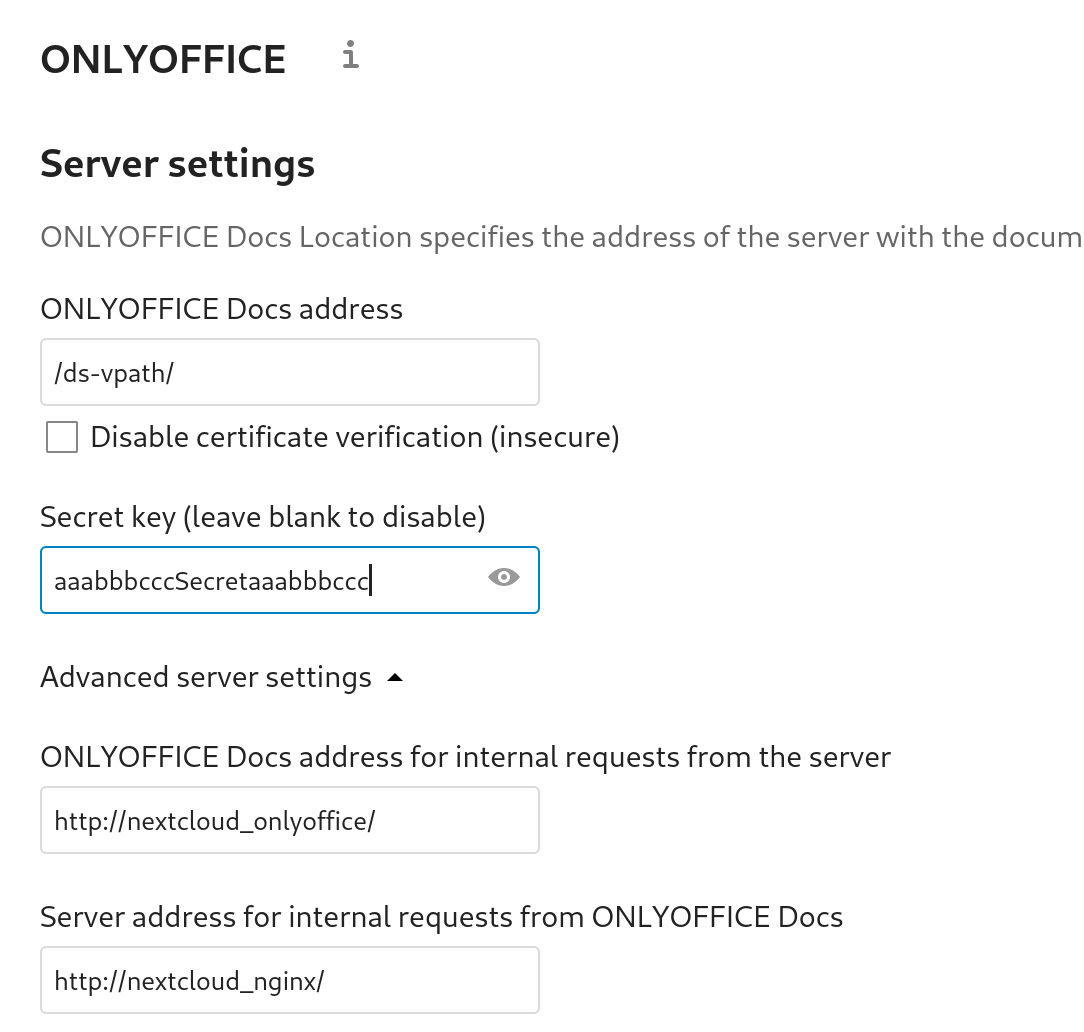

In config.php I also have :
array (
'verify_peer_off' => true,
'jwt_header' => "AuthorizationJwt"
Settings are as is and from each pods I can ping both ways by the DNS name.
But, when I do ‘Save’ I get :
Error when trying to connect (Error occurred in the document service: Error while downloading the document file to be converted.) (version 7.2.1.34)

When I open https://nextcloud.example.com/ds-vpath/ I get the OO test webpage. I can create a document, but when I try to open the file for editing, it’s only blank.
What else should I check?
