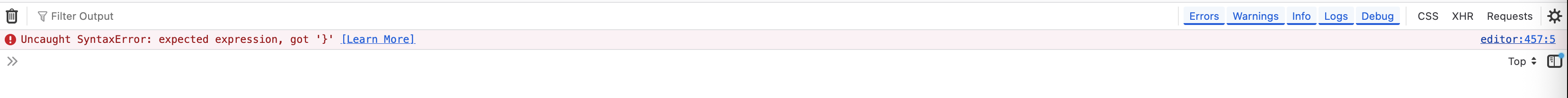

I’m trying to update Onlyoffice from v9.0.2 to v9.0.3 but with v9.0.3 I’m suddenly not able to open the editors. When I inspect the editor page, I see the following error in the browser console:
The syntax error is a missing value for submitForm in the editor script:

        "submitForm":
I double-checked v9.0.2 (which works) and here it has "submitForm": true.

Hello @J_whits,
Does this error occur in the test example as well (documentserver_url/example)? What happens if you specify the value mentioned above?
Hi @DmitriiV
Thanks for your reply.
The issue has been resolved. The problems was in the Nodejs integration and not in the documentserver. Specifically, it turned out that I was using an outdated version that, among other things, didn’t contain the submitForm entry in the constructor methods for users. Adding this solved the issue.
