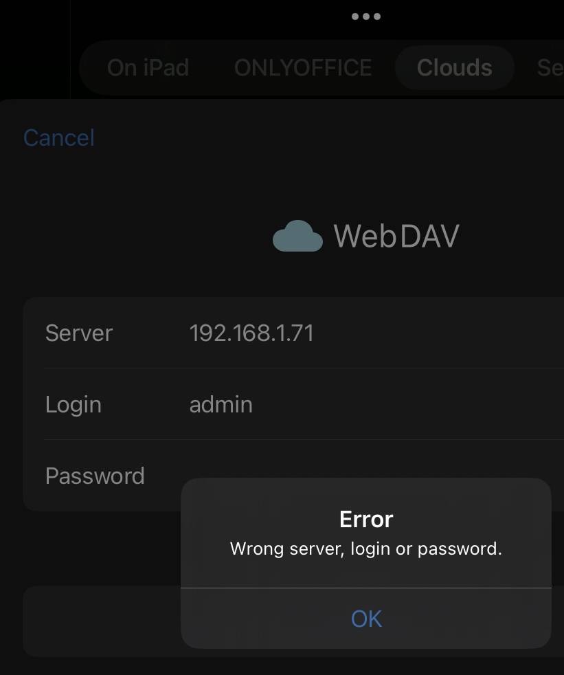

When I try to add this WebDAV ‘cloud’ to ONLYOFFICE, I get a general bad address/username/password error. I suspect my server name encoding using the IPv4 address or lack of https is the problem.

Hello @HlcRaleighNC
Does it allow you to connect via any other app? What WebDAV utility is used to start up a server?
In general, usually WebDAV uses some kind of endpoint instead of the address of the server where it is located. If possible, please consult with the documentation of your WebDAV app to find more information in this regard.

The NAS server (in this case a Buffalo NAS) is the WebDAV server - there is no WebDAV utility. The NAS server is listening on tcp port 9000. It does not support https (it is 10 yrs old).

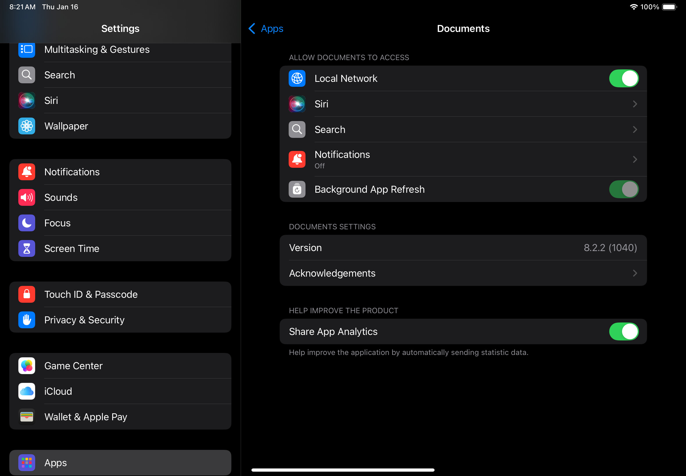

Could you please double check that the app has necessary rights?

iPadOS access for Document app to local network enabled. Unencrypted username and password to select a NAS share. Anonymous access to select a default share.

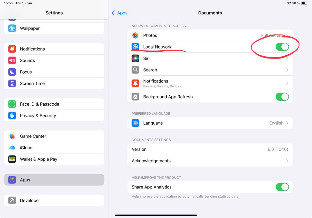

HI Guys, just quickly made an account on website to reply to this thread.
I had the same issue as @HlcRaleighNC had.
I FIxed the problem by adding http://ipaddress:port/ - important to highlight http instead of https because my server wasnt on https.
Also on your iphone, go to settings, search for documents click the onlyoffice icon and makesure you select local network enable.
