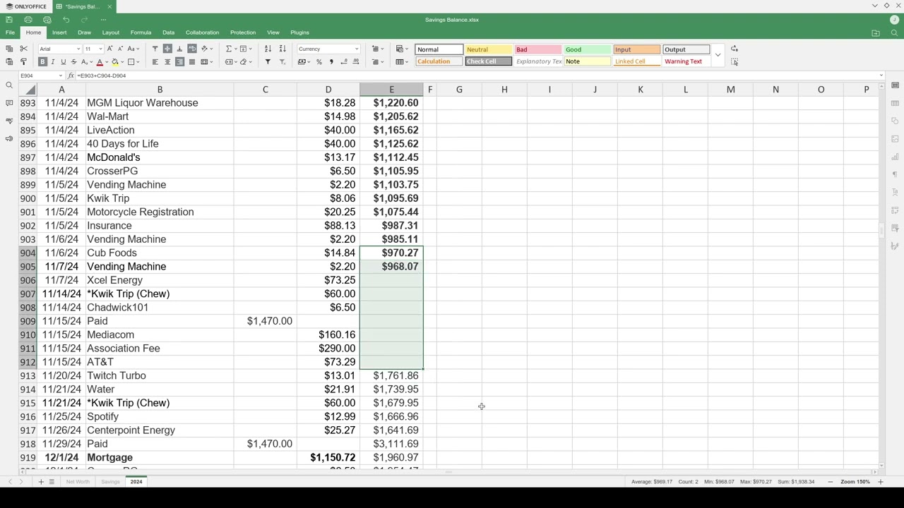

This is a very weird bug that I just started experiencing on my new computer that I put together this past Wednesday. I’ve been using OnlyOffice Calc for years to do my personal finance spreadsheeting, without issue. The spreadsheet is on a network drive, and works perfectly on both of my other Linux PCs, and my Windows PC (and also on the Linux PC this new one replaced).
When I type a formula into a cell (=E10-C11+C11, or even =10+10) and press enter, the formula box at the top shows the formula as typed, but the cell is blank. The font is set to Arial 11 automatic color, and I still get nothing if I change the font or the font color. If I save and close the spreadsheet, and calc, and reopen it, the cell shows the formula’s result correctly.
I’ve spent the last 2-3 days trying various versions of OnlyOffice, checking and unchecking the “Use graphics acceleration when available *” box, altering which compositor renders the window, and whatever else I could figure out (even going so far as asking ChatGPT, which basically walked me through all the things I’d already tried), with no results at all. I can’t figure out why this would even be happening, so it’s been a real brain stretch to guess and test various possibilities.
It might be a long shot, but I figured I would ask here and see if anyone has any idea what’s even happening. For any super nerds, I’ve tried using X11 and Wayland, same problem on both, and I’m using Arch with KDE Plasma.

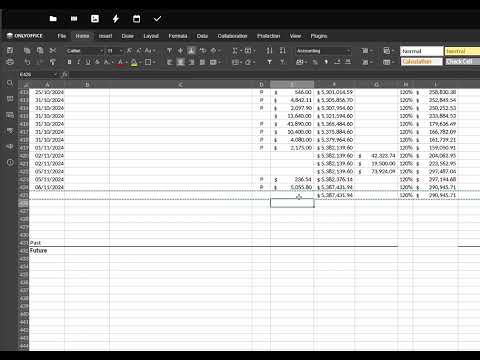

So if I take the newly opened file, and I insert a line at a position it will replace some existing formulas with empty cells, others with #NUM!.
if I then downloaded a copy of the file to my local machine and opened it in using microsoft office, while the editing is still blocked office shows the same output. So this would appear to be something to do with the rendering engine rather than the graphics

Thanks Alex, here you can find a video of this issue. This is a bit different to what I see but the same effect and likely same root cause. It will not let me share the video so I put on YT.

I reproduced the issue on Arch with KDE Plasma 6.2.2, Archcraft with OpenBox (both on Kernel 6.11.6-arch1-1), and on Debian Bookworm (in a VM and on hardware with KDE Plasma 5.27.5, Kernel 6.1.0-26-amd64).
I have recorded a video showing the issue I’m describing. When I drag down to copy and paste a formula, the formula pastes into the cell as it should (I highlight the formula bar to show the correct formula is in fact shown), but the cell shows as blank. When I close the program (saving my changes) and reopen it, the results of the formula show again as they should.
