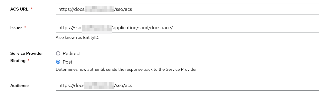

We have Authentik as our IdP, and I created a provider as follows:

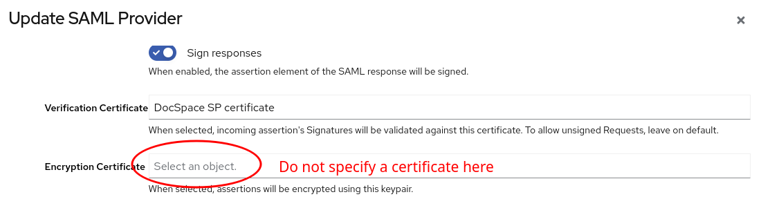

On the DocSpace side of things, I configured stuff as follows:
Now, when I try to log in using SAML, the IdP logs say everything is hunky dory, but the authentication fails:
I set up a tail -f on all log files prior to trying the SSO login, and here is the output. Everything seems fine (HTTP 200 OK) up until an including GET /api/2.0/settings?withPassword=true, which gets a HTTP 200 OK, but the next requests are for the login error page/message.
Nothing else is in the logs anywhere. How can I figure out why this is not working?
