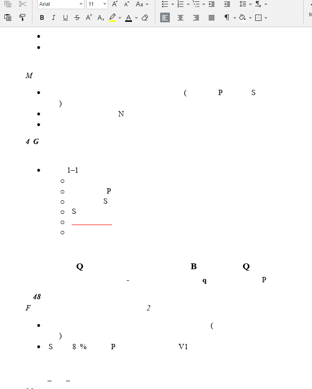

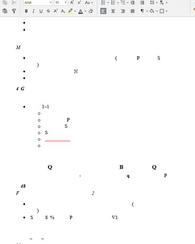

I discover the odd state when I return to a doc and realize that the content no longer appears as normal text, rather mainly a blank page with random partial characters or lines.
After this occurs, I am not able to do anything other than close the app.
… and not sure if I should ‘Save’ or not, as Saving may save the distorted or damages doc. So I’ve closed w/o Saving. Recent adds to the doc are lost once I re-open the app.

Well it froze again, and this is what the document looks like.

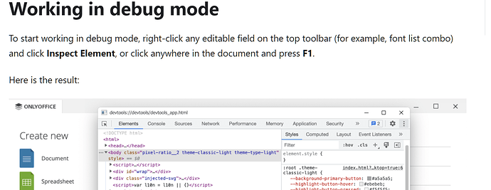

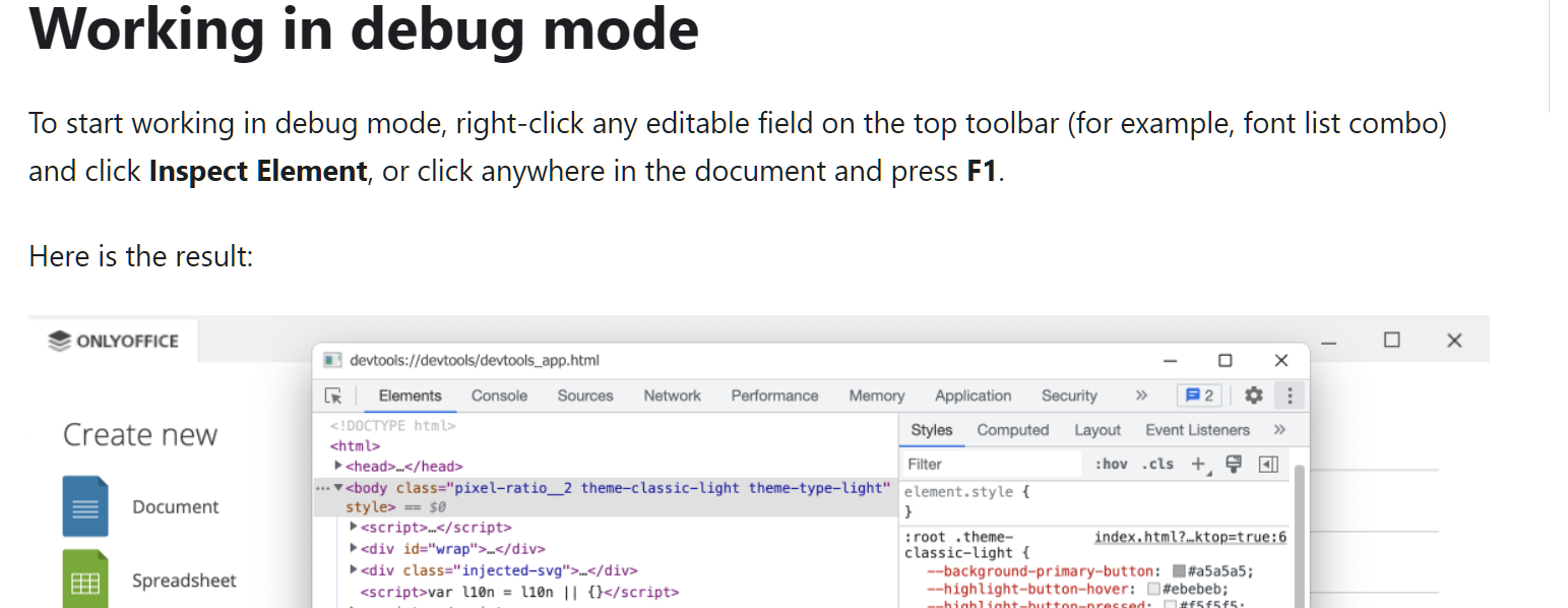

I agree with Constantine that the issue seems to be related to video rendering process. However, we can check if there’re any errors in the app itself.
Please try to enable debug mode and work with the editor as usual: Running in debug mode on Windows | ONLYOFFICE
Once the issue occurs again >hit F1 button and check Console and Network tabs > make a screenshot of any error entries.
One more thing. Go to the app > Settings . Please check this parameter:
Try to change it and check the result.

Apparently a space is needed before –ascdesktop-support-debug-info, as without a space it was denied but was accepted, I think, with a space… as I noticed in the 2nd option.
I “assume” that after doing this, I just click the app icon to open as usual and it “will” be in Debug Mode…? How will I know?
I don’t understand this at all.
What is an editable field in the top too bar?
Do I open a document first or not?
Please give details.
