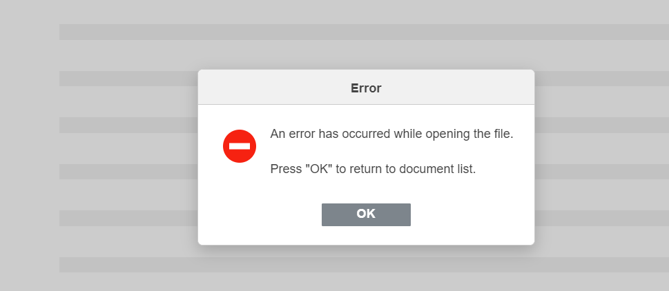

When I used the spring example on the official website, an error occurred in opening the file:An error has occurred while opening the file
I hope to get some help, thank you.

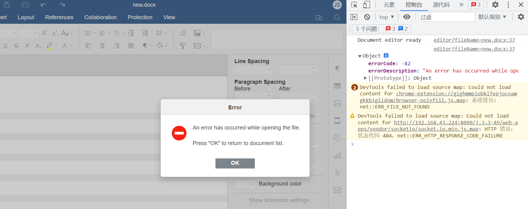

Please provide a screenshot of the browser console when this error pops up.
Additionally, share Document Server logs that are located in C:\Program Files\ONLYOFFICE\DocumentServer\Log\ after reproducing the issue for analysis.
This is a screenshot of the browser:
