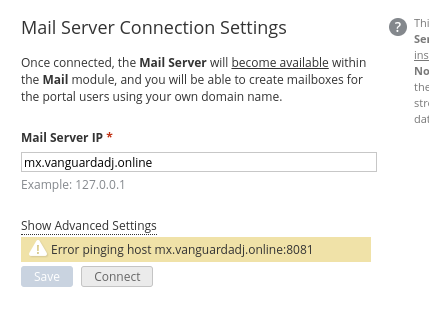

I am trying to install workspace on my digitalocean droplet and have mail server activated on the same. However every time I put the IP address I get error that can’t connect to port 8081 and when I open it up it says can’t connect to port 3306. And when I run docker of MySQL server on that port, the whole community server collapses and is not accessible or available. I have been on this for the past 5 days.
Hello @givenality
Please point me to the guide which you used for Workspace installation.
Please reproduce the situation and make screenshots. Also please provide us with whole Community server and Mail server logs folders. For docker, they are located here (on the host):

I have the same issue. I am also using a digital ocean droplet for my workspace server.
I installed the mail module through the control panel here:
I followed the directions to add a MX record to the A section of my custom domain from this link: https://helpcenter.onlyoffice.com/installation/mail-install-docker.aspx
Here is the error message:
I also tried the IP address of the server and got the same result. I have no ufw firewall and already did the iptables commands to accept ports 8081 and 3306.
What is the resolution here?

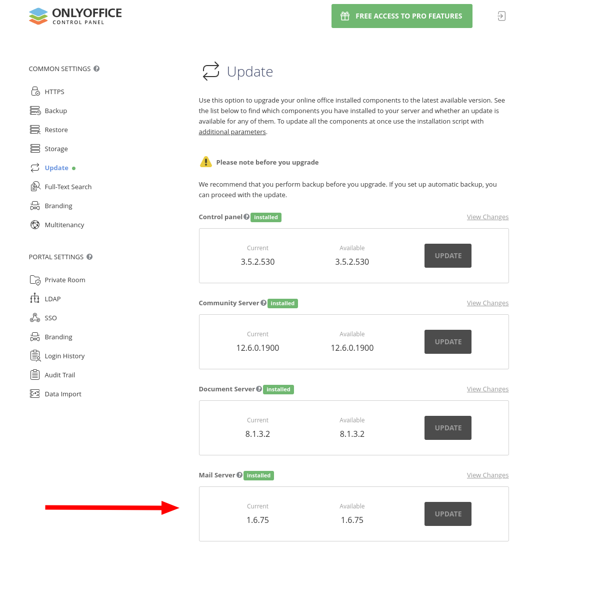

Hello @zionad
Thank you for the provided logs. it seems that Community server cannot connect with Mail server. Please go to the host and double check that specified container address is correct (127.0.0.1). You can check it with docker inspect command. Please let us know the result.
It doesnt appear that the mail server has an assigned address.
Here is the output for the mail server:

Here is the output for the community server:

For reference, the domain I am trying to use for mail is vanguardadj.online. I have already put in the A record in the domain settings. Here is the results of the dig command (on the server):
root@office:~# dig -t A mx.vanguardadj.online; <<>> DiG 9.18.28-0ubuntu0.22.04.1-Ubuntu <<>> -t A mx.vanguardadj.online;; global options: +cmd
;; Got answer:
;; ->>HEADER<<- opcode: QUERY, status: NOERROR, id: 256
;; flags: qr rd ra; QUERY: 1, ANSWER: 1, AUTHORITY: 0, ADDITIONAL: 1
;; OPT PSEUDOSECTION:
; EDNS: version: 0, flags:; udp: 65494
;; QUESTION SECTION:
;mx.vanguardadj.online. IN A
;; ANSWER SECTION:
mx.vanguardadj.online. 6572 IN A 206.189.252.75
;; Query time: 0 msec
;; SERVER: 127.0.0.53#53(127.0.0.53) (UDP)
;; WHEN: Tue Sep 17 14:07:48 UTC 2024
;; MSG SIZE rcvd: 66

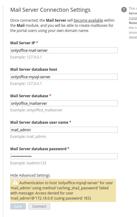

Hi @zionad ![]()
Thank you for providing the information.
It seems the connection issue might be related to the current Mail Server IP configuration.
Please try the following steps:
- In the “Mail Server IP” field, enter the container name
onlyoffice-mail-server - In the “Mail Server database host” field, enter the container name
onlyoffice-mysql-server
Additionally, could you please provide the output of the following command for further troubleshooting:
docker ps -a
Hi Nikolas, here is the result of those steps:
I used the database password that I setup, and even tried the default “my-secret-pw”. I think the username might be incorrect.

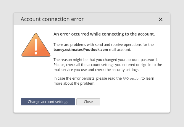

Hi @Nikolas, as of this morning, we have completely lost all access to 0auth Microsoft email accounts. See screenshot:
How is the progress on my mailserver issue? We desperately need an option to host our own email for internal CRM use. There is alot of correspondence that is piling up.
Hi @zionad
The error message specifically points to a failed authentication method caching_sha2_password
As far as I know, we have been using the mysql_native_password authentication method. The issue you’re seeing might be due to the fact that caching_sha2_password is being used instead.

Well, the password issue comes down to the 0auth feature change that all Microsoft email products have switched over to as of a week ago.
But my main problem is that the mail server I installed through the control panel in Workspace is not able to communicate with the Workspace Community module. The instructions in the support area (Adding ONLYOFFICE Mail to ONLYOFFICE Workspace installation - ONLYOFFICE) said that after installing the mail module through control panel, the mail server would be available in the Workspace. Except when I go to the mail settings in Workspace I see that it still needs to connect to the mail server manually and I am getting an error where it cannot communicate.
All that information is above our posts here, along with the results of the last query you asked me to perform on the mail server.
Also, I dont know if it is relevant, but here is the output of the dig commands on the workspace server (Digital Ocean Droplet):

Is the PTR answer incorrect?

I understand that your installation was on a DigitalOcean droplet, and that you enabled the mail server after the initial setup. I appreciate your concerns about downtime for your company.
We are currently aware of a bug affecting the mail server connectivity. Specifically, there is an issue where the mail server installed via the Control Panel does not connect properly. Our team is actively working on a fix for this issue.
Based on your current situation, without delving deeper into the database or verifying the successful creation of the mail_admin user and onlyoffice_mailserver database, I would recommend the following course of action:
- Backup your data: Create a backup of your current setup and save it locally. For guidance on how to back up, please refer to the OnlyOffice Backup Documentation.
- Retrieve the machine key: You can find it in the following path:
/app/onlyoffice/CommunityServer/data/.private/machinekey. - Remove existing containers and data: Delete the containers and clear the data in the
/app/directory. - Reinstall ONLYOFFICE Workspace: Initiate the installation again with the mail server by using the
-mdparameter and include your old machine key with the-mkparameter. Detailed installation steps can be found in the OnlyOffice Installation Guide. - Restore the backup: After the reinstallation, restore your backup through the control panel.
- Run the installation script again: Execute the installation script one more time, adding the
-u trueparameter. - Locate the mail server container IP: Use the command
docker inspect onlyoffice-mail-serverto find the IP address of the mail server container. - Configure mail server settings: In the portal settings, enter the following:
- Mail Server IP: the IP address of the mail server container (IMPORTANT: ensure you use the IP address)
- Mail Server database host:
onlyoffice-mysql-server - Leave the other parameters at their default values.
Finally, connect and save the settings. This process should resolve the connectivity issues you are experiencing.
