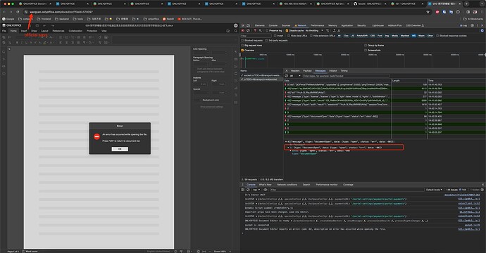

This error is not limited to the Docker version; the official website’s SASS version also encounters the same issue.
Here is the error message
[2023-12-08T05:40:05.391] [INFO] [localhost] [172.17.0.1000-_____-__________________________2___2_.docx1702014003692] [uid-1] nodeJS - Start Task
[2023-12-08T05:40:05.741] [DEBUG] [localhost] [172.17.0.1000-_____-__________________________2___2_.docx1702014003692] [uid-1] nodeJS - downloadFile complete filesize=39824639 sha256=fa6ec5a4e232350f785160893800eec309c553ab269345199180864e909a5188
[2023-12-08T05:40:10.463] [ERROR] [localhost] [172.17.0.1000-_____-__________________________2___2_.docx1702014003692] [uid-1] nodeJS - stdout:
[2023-12-08T05:40:10.463] [ERROR] [localhost] [172.17.0.1000-_____-__________________________2___2_.docx1702014003692] [uid-1] nodeJS - stderr:
[2023-12-08T05:40:10.463] [ERROR] [localhost] [172.17.0.1000-_____-__________________________2___2_.docx1702014003692] [uid-1] nodeJS - ExitCode (code=0;signal=SIGSEGV;error:-80)
[2023-12-08T05:40:10.463] [DEBUG] [localhost] [172.17.0.1000-_____-__________________________2___2_.docx1702014003692] [uid-1] nodeJS - output (data={"ctx":{"tenant":"localhost","docId":"172.17.0.1000-_____-__________________________2___2_.docx1702014003692","userId":"uid-1"},"cmd":{"withAuthorization":true,"wopiParams":null,"c":"open","id":"172.17.0.1000-_____-__________________________2___2_.docx1702014003692","userid":"uid-1","format":"docx","url":"http://192.168.10.6:9001/example/download?fileName=xxxx.docx&useraddress=172.17.0.1","title":"xxxxx.docx","outputformat":8193,"outputpath":"Editor.bin","embeddedfonts":false,"status_info":-80,"lcid":9,"nobase64":true,"convertToOrigin":".pdf.xps.oxps.djvu"}})

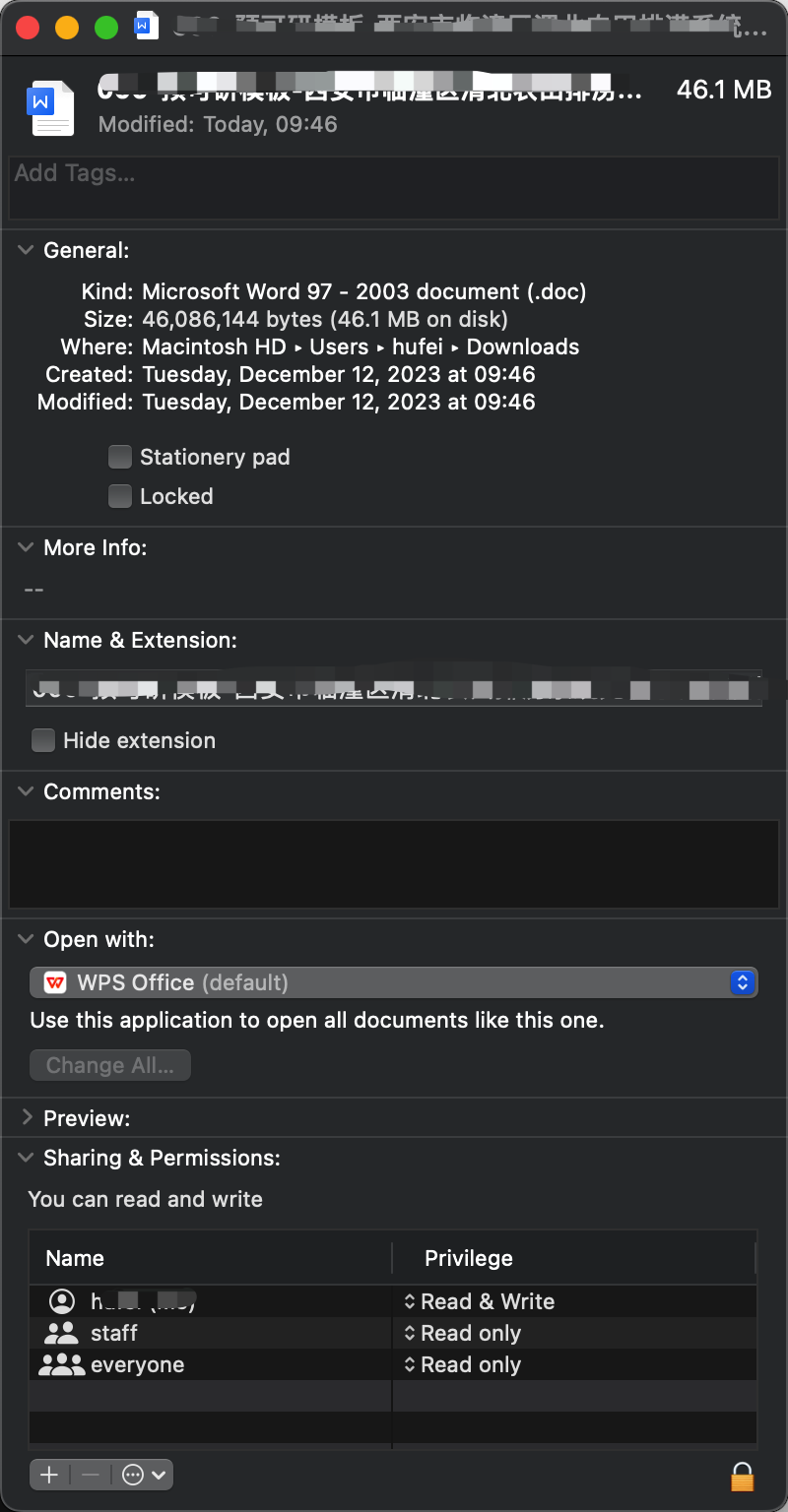

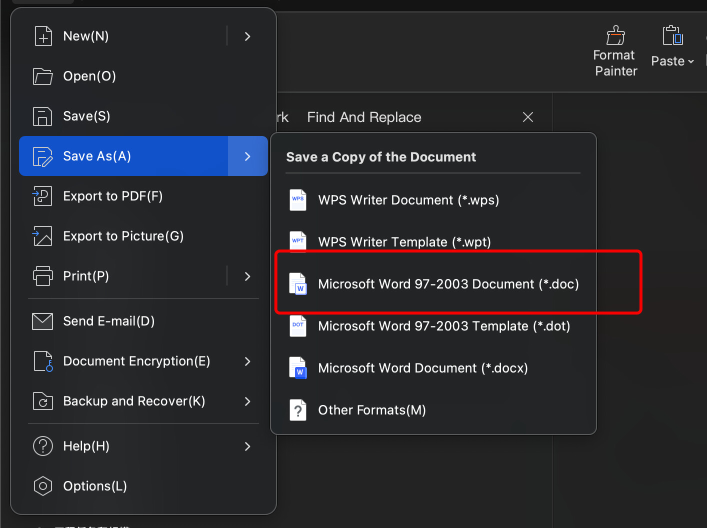

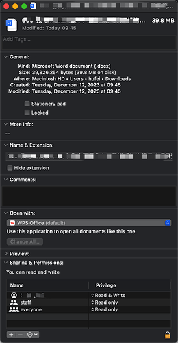

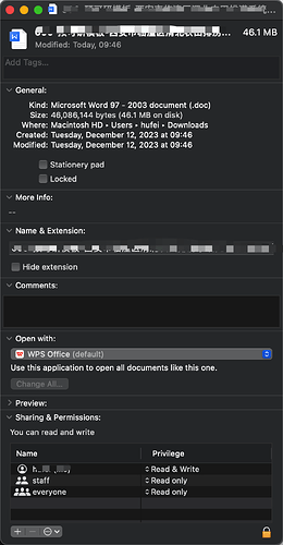

2.The temporary solution
My current temporary solution is to manually convert it to Word 97-2003 version using Microsoft Word, which resolves the issue.
