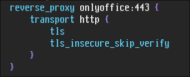

update: had to do what caddy told me not to use in production:

Thanks, unfortunately doing the exact same thing via caddy didn’t work in my case. As mentioned, all I got were 502s, that’s why I had to employ that weird https workaround.
IIRC I even got 502s connecting to the http port without any proxy in between. The same worked flawlessly via https.
