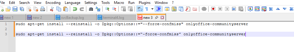

I think I may have found the issue. I compared your command with mine:
It seems that your command (the second line) contains different quotation marks and is missing a dash. Could you please try again and copy and paste my example?
sudo rm -rf /etc/nginx/sites-available/onlyoffice
sudo apt-get install --reinstall -o Dpkg::Options::="--force-confmiss" onlyoffice-communityserver
I think I missed something

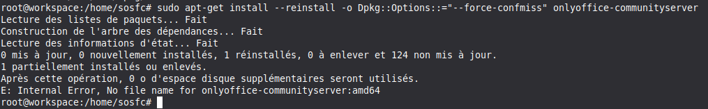

root@workspace:/home/sosfc# sudo apt-get install --reinstall -o Dpkg::Options::=”–force-confmiss” onlyoffice-communityserver
Lecture des listes de paquets… Fait
Construction de l’arbre des dépendances… Fait
Lecture des informations d’état… Fait
0 mis à jour, 0 nouvellement installés, 1 réinstallés, 0 à enlever et 124 non mis à jour.
1 partiellement installés ou enlevés.
Après cette opération, 0 o d’espace disque supplémentaires seront utilisés.
E: Internal Error, No file name for onlyoffice-communityserver:amd64
Hello @sosfc
Something is going wrong on your server. You downloaded the package previously, so the current error is a bit confusing.
Please try the following steps to update the package indexes and clear the cache:
sudo apt-get clean
sudo rm -rf /var/lib/apt/lists/*
sudo apt-get update

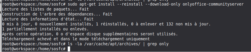

If the issue persists, please run the following commands to download the package:
sudo apt-get install --reinstall --download-only onlyoffice-communityserver
ls -la /var/cache/apt/archives/ | grep onlyoffice
sudo dpkg -i /var/cache/apt/archives/onlyoffice-communityserver_12.8.0.1971*.deb

Hi, thanks for your reply.
It seems that you found the problem. The server does not want to download the onlyoffice-communityserver deb file

Hi
There is the result :
root@workspace:/home/sosfc# apt-config dump | grep -i Keep-Downloaded-Packages
Binary::apt::APT::Keep-Downloaded-Packages “0”;
root@workspace:/home/sosfc# find /var/cache/apt -name “onlyoffice-communityserver*.deb”
root@workspace:/home/sosfc# apt-get -o Debug::pkgAcquire::Worker=1 --reinstall --download-only install onlyoffice-communityserver
0 mis à jour, 0 nouvellement installés, 1 réinstallés, 0 à enlever et 132 non mis à jour.
Téléchargement achevé et dans le mode téléchargement uniquement

root@workspace:/home/sosfc# sudo apt-get install --reinstall -o Dpkg::Options::=“–force-confmiss” onlyoffice-communityserver
0 mis à jour, 0 nouvellement installés, 1 réinstallés, 0 à enlever et 137 non mis à jour.

sudo apt install /tmp/onlyoffice-communityserver.deb -o Dpkg::Options::=“–force-confmiss”

    dpkg: erreur de traitement du paquet onlyoffice-communityserver (–configure) :
    le sous-processus paquet onlyoffice-communityserver script post-installation installé a renvoyé un état de sortie d’erreur 1
    Des erreurs ont été rencontrées pendant l’exécution :
    E: Sub-process /usr/bin/dpkg returned an error code (1)

░░ Subject: L’unité (unit) nginx.service a échoué
░░ Defined-By: systemd
░░ Support: Debian -- User Support
░░ L’unité (unit) nginx.service a échoué, avec le résultat failed.
The line 19 of my file is
{{DOCKER_APP_SUBNET}} 0;
But I don’t have docker installed on this server (packages version)
  1. ^# ↩︎
  2. ^# ↩︎
Please move the config from sites-enabled as well:
sudo mv /etc/nginx/sites-enabled/onlyoffice /etc/nginx/sites-enabled/onlyoffice.bak
and run the previous steps again:
sudo mv /etc/nginx/sites-available/onlyoffice /etc/nginx/sites-available/onlyoffice.bak
wget http://download.onlyoffice.com/repo/debian/pool/main/o/onlyoffice-communityserver/onlyoffice-communityserver_12.8.0.1971_all.deb -O /tmp/onlyoffice-communityserver.deb
sudo apt install /tmp/onlyoffice-communityserver.deb -o Dpkg::Options::="--force-confmiss"
Please let us know the result.
