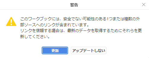

This spreadsheet has the following issues:
  1. When I open the spreadsheet, the warning appears, but the link is not found.

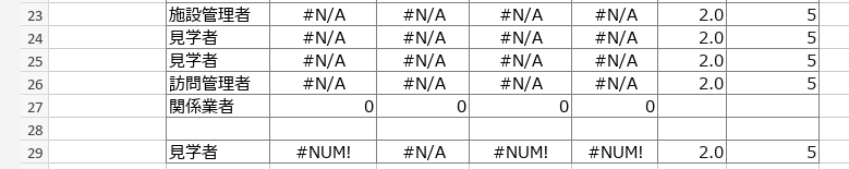

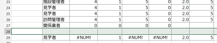

  2. If I insert a row above the last row, the values in the last row will be “#NUM!”.
  3. After I overwrite and close the spreadsheet, If I reopen it then the values in previous rows will be “#N/A”.

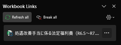

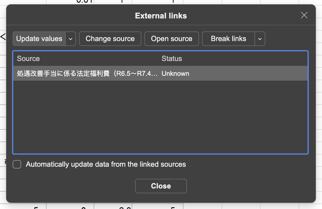

Hello @nishigaki
Apparently there is 1, or it was there:
This is just a visual quirk, but will take a closer look at it.

In Excel, since the link does not exist in any cell, it does not appear in the external links list and cannot be deleted. On the other hand, in desktop editors, is it the specification that links not referenced from a cell are displayed?
About “#NUM!” and “#N/A”.
I opened the spreadsheet from the local device.

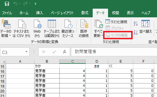

Possibly we are using different versions of MS Excel for tests, but I can see the link there too:
Thanks for the video. Unfortunately, performing the exact same steps did not produce the issue with #N/A in my case. In one of your other topics I’ve suggested to reinstall Desktop Editors with the MSI installer for Windows 11, did you have a chance to do that? Is this screen recording made after the reinstallation?

I use MS excel 2019(japanese), I can’t click a edit links button. Is this a problem with my MS Excel?

However, when I tried this in Docs, adding a row displayed “#NUM!” and “#N/A.” ONLYOFFICE
Unfortunately, I do not know. It works for me with Excel from Microsoft 365 MSO (Version 2508 Build 16.0.19127.20192).

Since it works in newer versions of Excel, I believe this is a change in Excel’s specifications and the warning issue is resolved.

@nishigaki, we have updated editors in DocSpace to the version 9.2 and the issue number 2 – last row displays #N/A after inserting a row above – has been fixed. Please check it out and share a feedback.

I checked it out. It’s solved.
