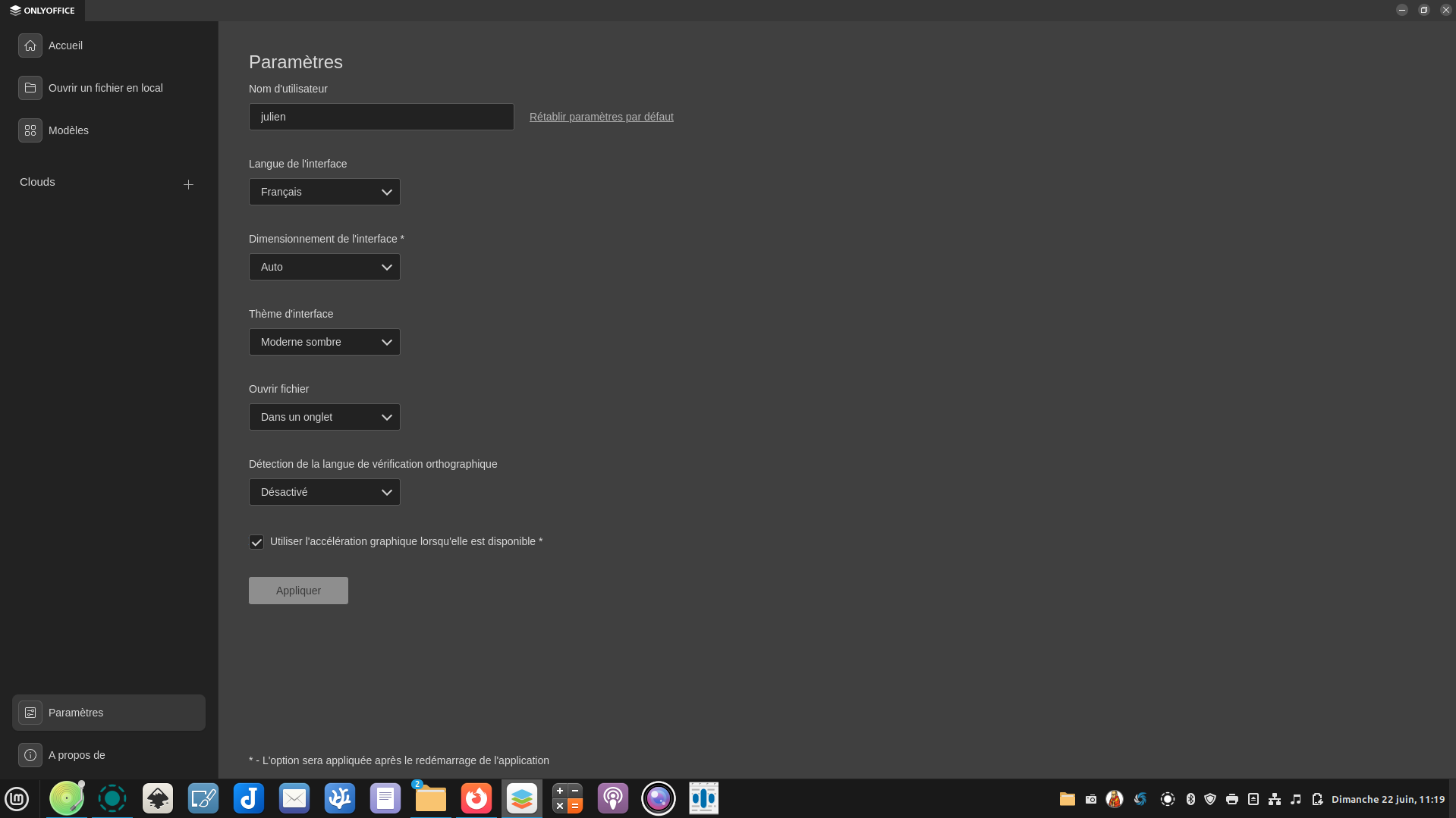

So, sorry but there is still an issue with autoscaling and here, there is no link with any external display :frowning:

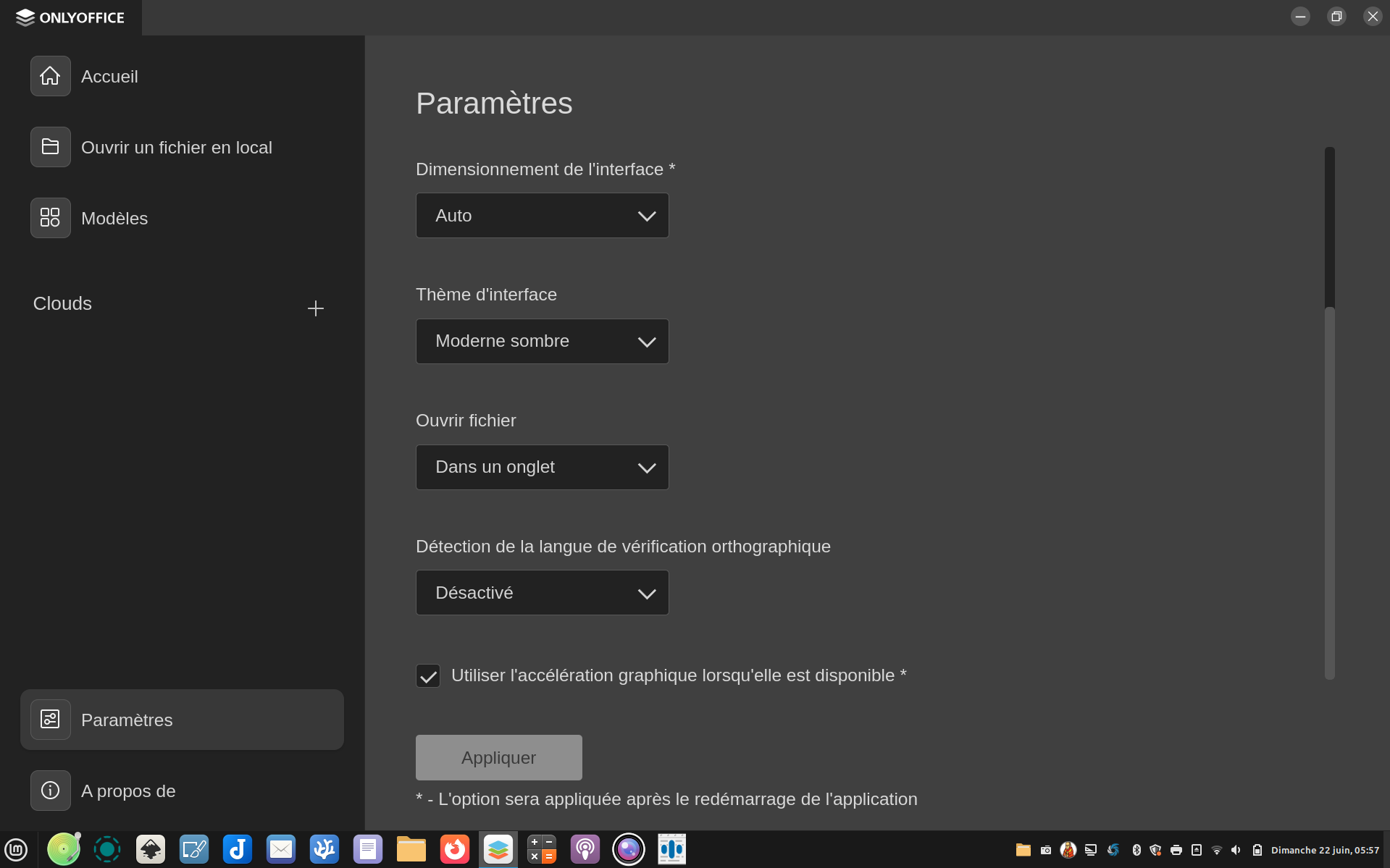

And on my external screen, with auto scaling set, everything is ok:
Is it the device with high-DPI screen?
It is my laptop yes.
Thank you. In that case everything works as I described here:
DPI of your laptop is high, which sets scaling of the editor to a high % value when Auto option is used, but on the external screen, where I could assume DPI is low, it calculates lower %, thus the interface is scaled normally.
