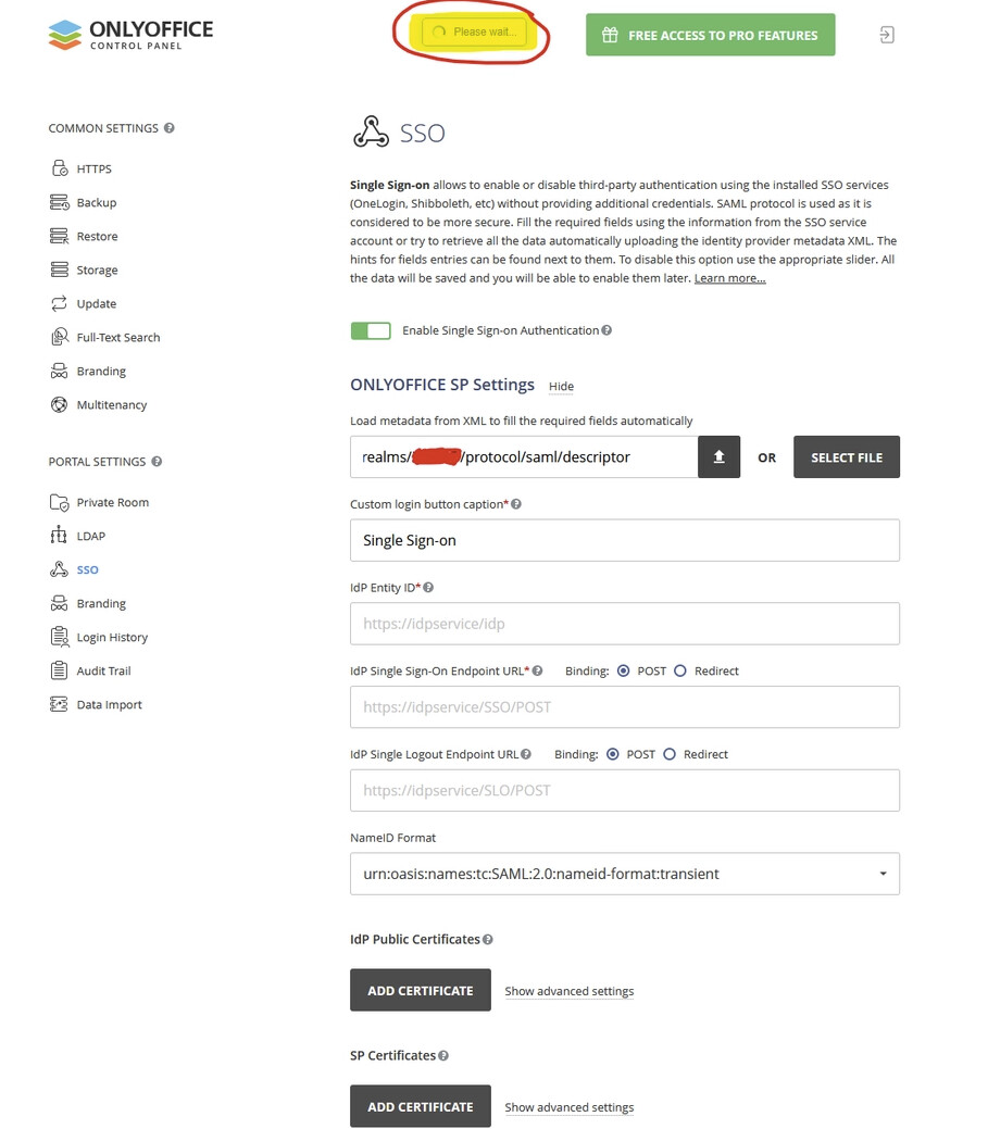

However, when connecting to KeyCloak SSO SAML, due to the use of Self-Signed Cert in the internal environment,
  1. OnlyOffice DocSpace: (HTTPS) can be easily configured successfully
  2. OnlyOffice WorkSpace: A. (HTTP) can be easily configured successfully
B. (HTTPS) Fail (see image)
After checking the Log: /var/lib/docker/volumes/onlyoffice_workspace_community_log/_data/web.sso.03-30.log
I found that
B. Log
[root@DockerHost ~]# tail -f /var/lib/docker/volumes/onlyoffice_workspace_community_log/_data/web.sso.03-30.log
{“error”:{“message”:“request to https://oows.example.com/ssologin.ashx?config=saml failed, reason: self-signed certificate in certificate chain”,
{“message”:“::ffff:127.0.0.1 - - [30/Mar/2026:09:07:14 +0000] "POST /loadmetadata HTTP/1.1" - - "-" "-"”,“level”:“info”}
