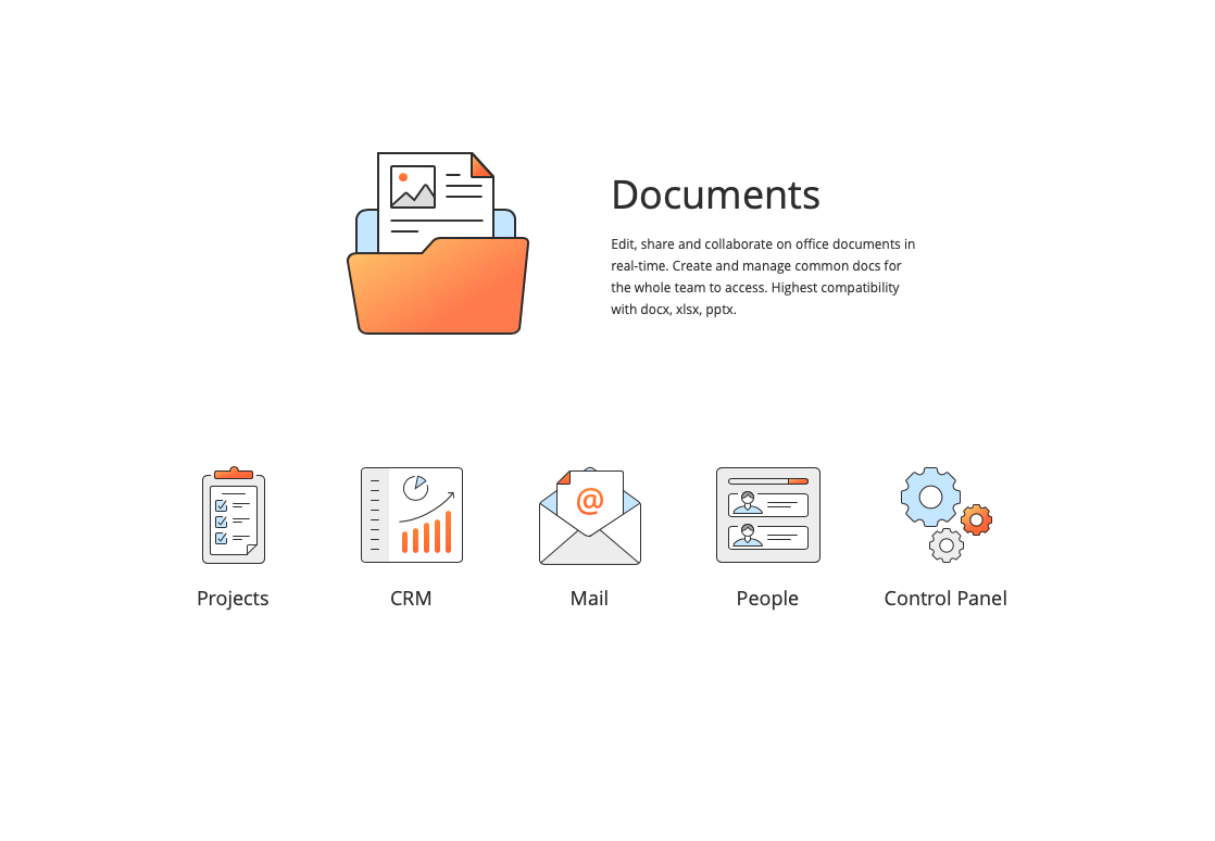

I asked our client about the “any error in the interface” question and they replied:
There is no error in the interface. It just resets back to the home screen

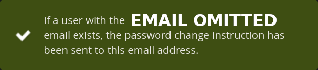

the URL from the Password Reset email isn’t resolving and is timing out
@carl is there a way I can update passwords directly in the MySQL database as password resets do not appear to work after data restores?
Or are some logs you could suggest I look at to try to track down this error?
I can’t see any evidence that any password reset email have been sent in the Postfix log at /var/lib/docker/volumes/docker-communityserver_mail_log/_data/maillog, there is however this pop-up when a password reset is requested:
Is there a log file other than maillog that would records outgoing SMTP email?
