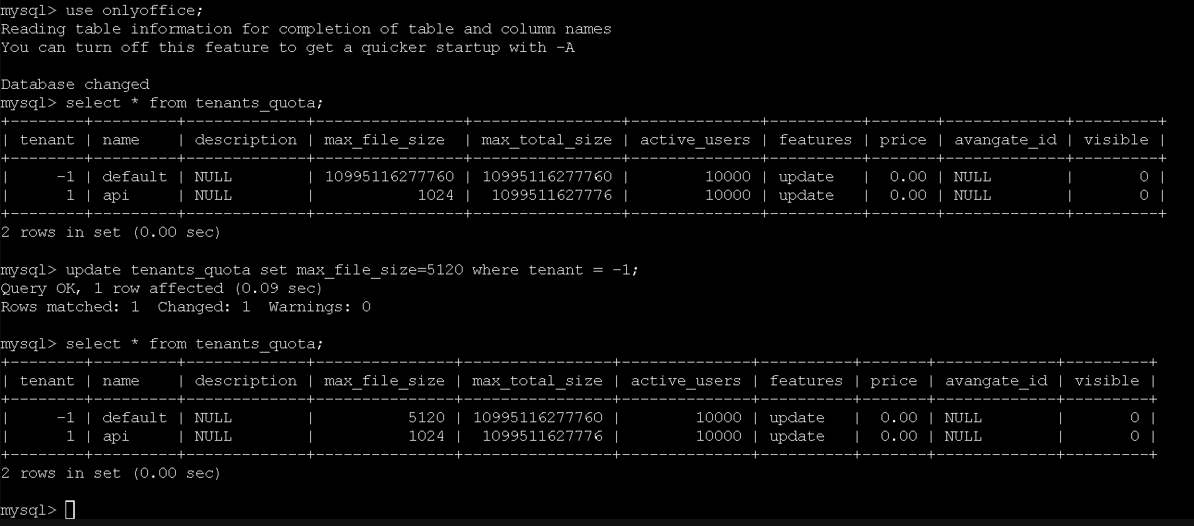

I noticed that there is an arbitrary 1GB limit to document upload by default. I’ve tried to increase the document upload limit on the Document feature of Workspace following this thread: Changing the 100Mb file size limit? - #6 by Constantine. However, when I run the update command, no rows are affected. When I select from tenants_quota, it returns:
mysql> select * from tenants_quota;
| tenant | name    | description | max_file_size  | max_total_size | active_users | features | price | avangate_id | visible |
|     -1 | default | NULL        | 10995116277760 | 10995116277760 |        10000 | update   |  0.00 | NULL        |       0 |
|      1 | api     | NULL        |           1024 |  1099511627776 |        10000 | update   |  0.00 | NULL        |       0 |
2 rows in set (0.00 sec)
I also tried setting the values for -1 (as shown) which does not fix the issue. Any ideas about why this is not working, or are there any alternate ways to increase this limit?

Hello @ltcptgeneral
Sorry for the late reply.
10995116277760 mb equals 10737418240 Gb. Please try again, but change it to 5120 mb for a test and let us know the result.
It was a sample in the Constantine command. You need to use the tenant ID which is already present in the database.

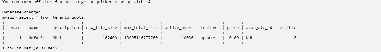

Hello @ltcptgeneral
Have you performed any actions with database in the past?

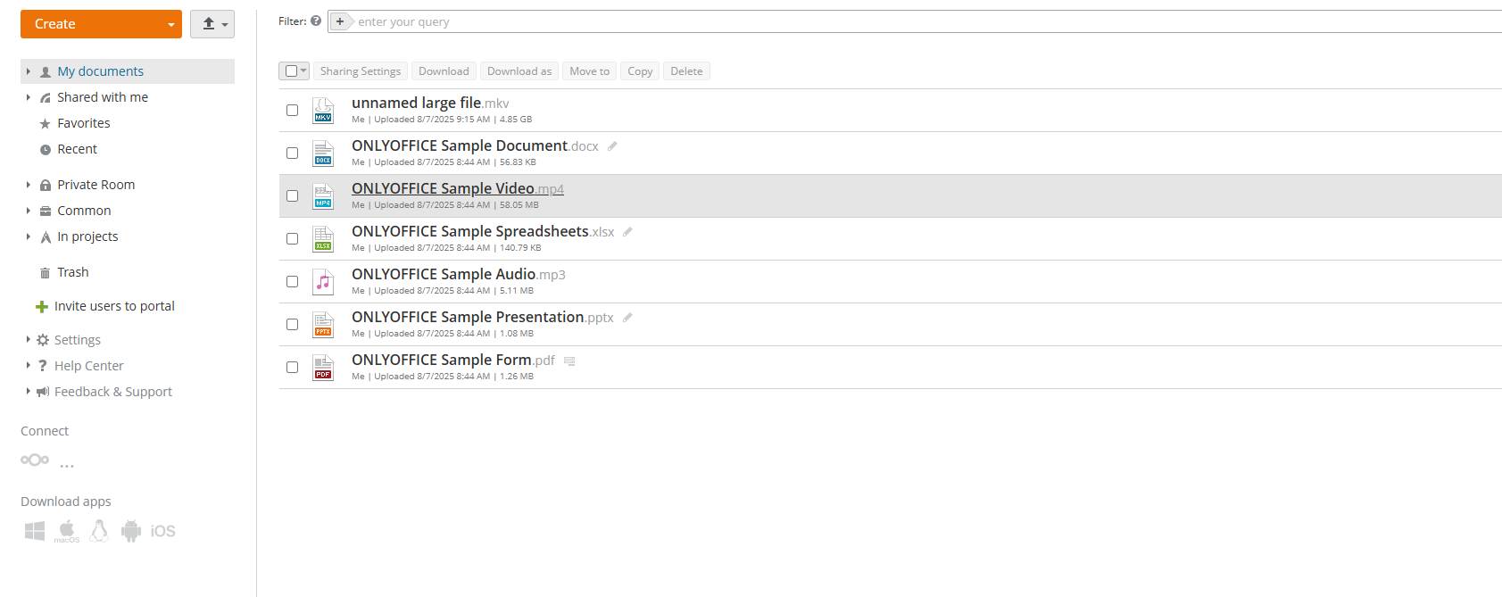

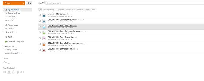

I have deployed fresh Workspace CE, and this table already contains large value for max_file_size:
I was able to upload large .mkv file (4 gb) without additional actions:
