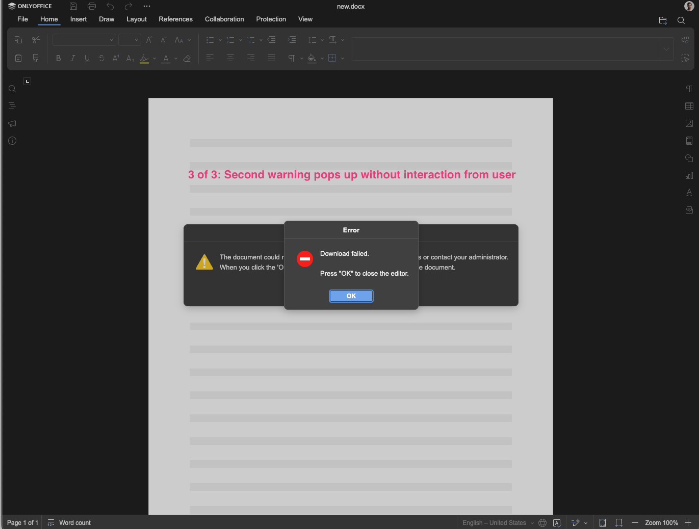

The forum will only let me upload one image so I’m including a view of the stacked errors after attempting to open the desktop editor for the sample dock.
So onlyoffice is running and accessible, but something is preventing the sample docs from being saved/used.
The error that is covered reads:
The document could not be saved. Please check connection settings or contact your administrator. When you click the “OK” button, you will be prompted to download the document.

Yes, I open via the highlighted link in this uploaded screenshot. If it is helpful, “viewing” a doc results in the same download error as attempting to edit it.

Such password protection will cause status code 401, when called from outside. For instance, in the integration with Nextcloud, the connector performs connectivity check to Document Server upon saving the settings, thus if Document Server is protected with a plain password, then it will fail with 401.
Specifically for such cases, JWT is used to sign the requests to and from Document Server. You can find more about it here:

Let’s take a look at Nextcloud integration for example. It has its own login interface that stores information as a cookie, thus users need to log in to Nextcloud to use the editors, they do not need to log in to Document Server separately.
At the same time, opening a document for editing uses JWT to secure the connection to open the document. That way, a crawler from outside Nextcloud cannot access the file, nor the editor. JWT authorizes requests from both services, which provides additional layer of security.
If there is need to put Document Server behind its own password protection, then there should a separate service that passes this authorization for incoming requests, because Document Server is a service and not a “user” for the storage it is integrated with. Thus using JWT and HTTPS provides stable security without a password protection of Document Server itself.
Both of these are available in Nextcloud integration as an example. Think about Document Server as a tool for editing the documents, you cannot access the tool without logging into the app, to which it belongs.
With JWT enabled, only the service with valid JWT credentials can access Document Server. Other than that, you can enhance the networking queries with a proxy. Examples for proxies are available here. With some tweaking you can even have Document Server not available to the public at all by routing the traffic to the local network, it’s up to you to develop the logic of handling networking queries.
