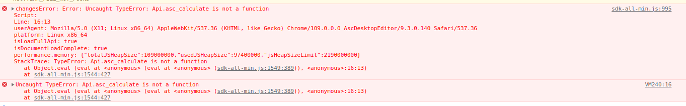

The macro throw an error in the reloadCellValues function (Api.asc_calculate is not a function).

In the devtools console we can see the error…

We have checked the situation: undocumented methods are no longer available for use in macros, so Api.asc_calculate(…) should not be used in this scenario.
Please use the documented method Api.RecalculateAllFormulas() instead. ​
