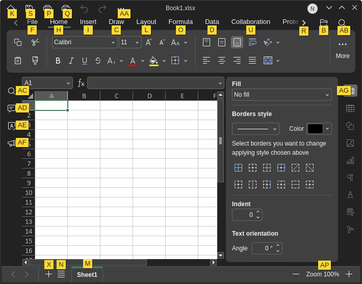

Behaviour: Program state is as if Alt has been pressed after task switching back from another application. Yellow boxes indicating available commands are all visible. Need to click once somewhere in the interface or press Alt again, otherwise any further keystrokes are taken as command input.
To replicate: Open any OnlyOffice document. Use Alt-Tab to switch away to another application. Use Alt-Tab again to switch back to OnlyOffice. Observe that OO has captured an Alt press and is waiting for additional letters to be typed for command input.

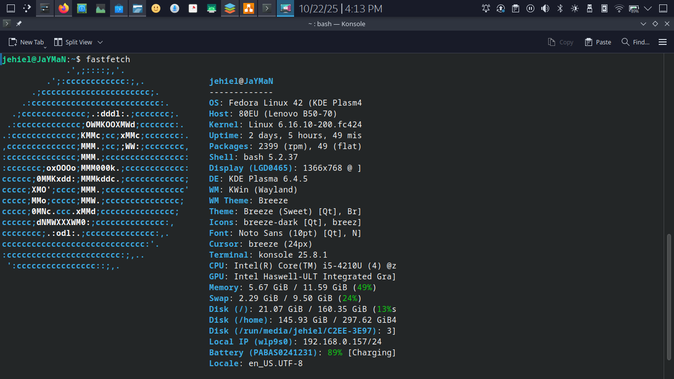

Please install the Neofetch/Fastfetch app and show us their output results (they are system information tools).

Please let us know your OS version and provide us with Neofetch/Fastfetch output result as well.

I have attached results from fastfetch. I am running on Fedora 42 and KDE Plasma 6.4.5
